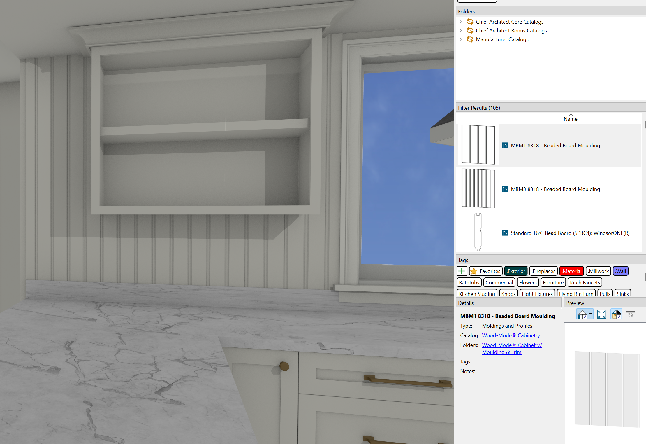

westvale Posted May 30, 2025 Share Posted May 30, 2025 Hello, Can anyone tell me how to accomplish a tongue and groove wall in Chief? I did manage to figure out how to get bead board with a molding polyline, but I would like tongue and groove, not beadboard. The first photo is the look I want, tongue and groove, and the 2nd photo shows the bead board I have but would like to replace. When I just replace the bead board with the tongue and groove, I get just a single board of tongue and groove. Hopefully that makes sense. Link to comment Share on other sites More sharing options...
Hoff_Design Posted May 31, 2025 Share Posted May 31, 2025 Try decking or siding then apply your finish. Link to comment Share on other sites More sharing options...
ericepv Posted May 31, 2025 Share Posted May 31, 2025 Core Catalogs / Materials / Siding & Paneling / Tongue & Groove 2 Link to comment Share on other sites More sharing options...
