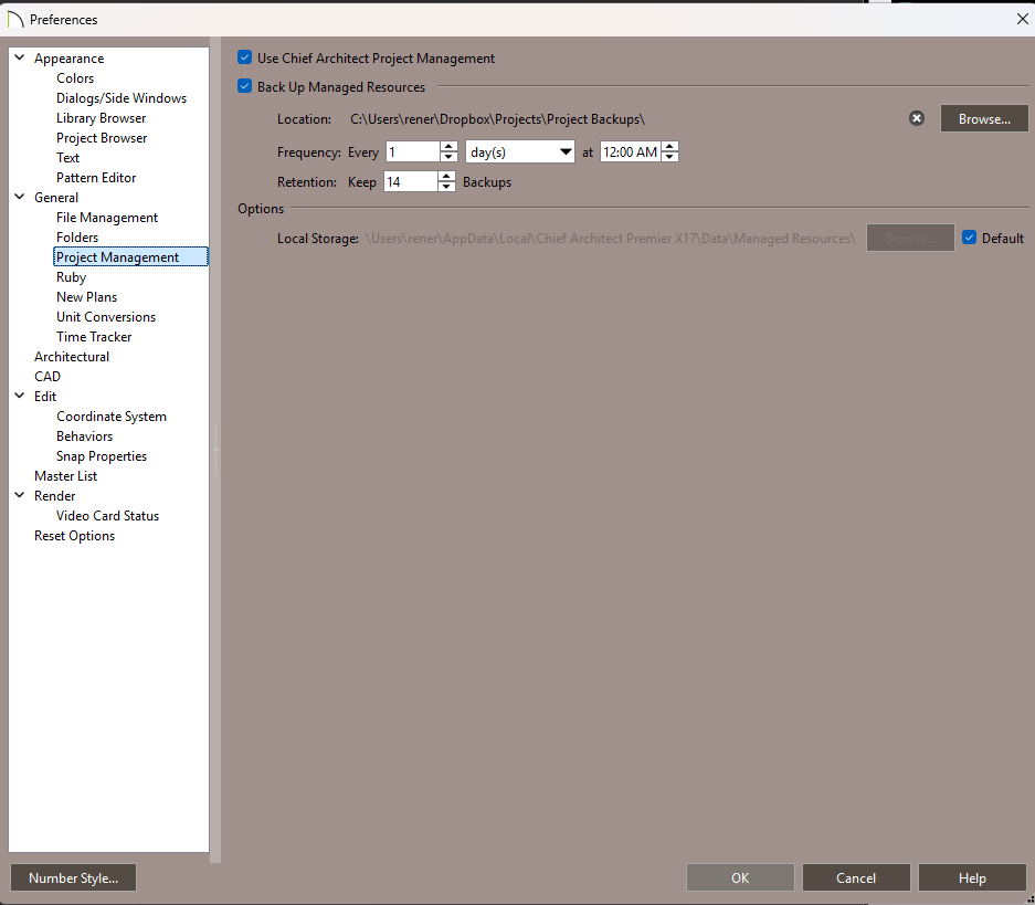

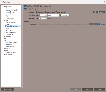

Artisan_TH Posted August 22 Share Posted August 22 I have a few project in the new system. I have saved every time I close a project System set to back up daily NO file in backup folder I have looked everywhere on my drives. NO zip file with .caproj Link to comment Share on other sites More sharing options...
Renerabbitt Posted August 23 Share Posted August 23 10 minutes ago, Artisan_TH said: I have a few project in the new system. I have saved every time I close a project System set to back up daily NO file in backup folder I have looked everywhere on my drives. NO zip file with .caproj The backup takes a long while and it prompts you before it performs and it will lock you out of using Chief until it completes. You would know it if it were backing up Link to comment Share on other sites More sharing options...
ClintonM Posted August 25 Share Posted August 25 On 8/22/2025 at 4:52 PM, Artisan_TH said: System set to back up daily NO file in backup folder On 8/22/2025 at 5:03 PM, Renerabbitt said: The backup takes a long while and it prompts you before it performs and it will lock you out of using Chief until it completes. Just to add some additional clarity here, Chief must also be running at the time at which the backup is scheduled to run. This means that if you are using the default backup preferences, Chief must be running at midnight. If Chief is not running at the time of a scheduled backup, you will be prompted to perform a backup the next time Chief is closed. Link to comment Share on other sites More sharing options...
