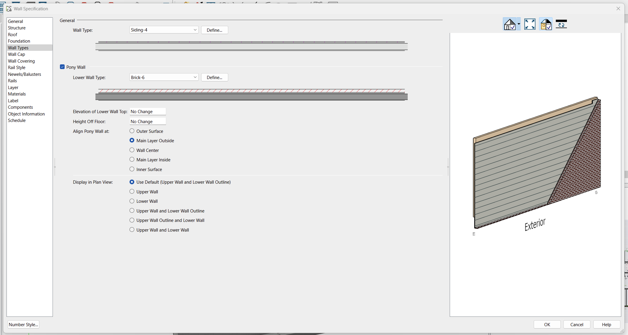

Solution JKEdmo Posted May 22, 2025 Solution Share Posted May 22, 2025 Shane, I changed the offending wall to have a brick pony wall below and then manipulated the pony wall heights in 3D elevation. Here's the result below. Give it a try. Jim 1 Link to comment Share on other sites More sharing options...
PitMan71 Posted May 22, 2025 Author Share Posted May 22, 2025 16 minutes ago, JKEdmo said: I changed the offending wall to have a brick pony wall below and then manipulated the pony wall heights in 3D elevation. Here's the result below. Give it a try. I will. Thanks. Didn't know you could edit the pony wall heights. Link to comment Share on other sites More sharing options...
