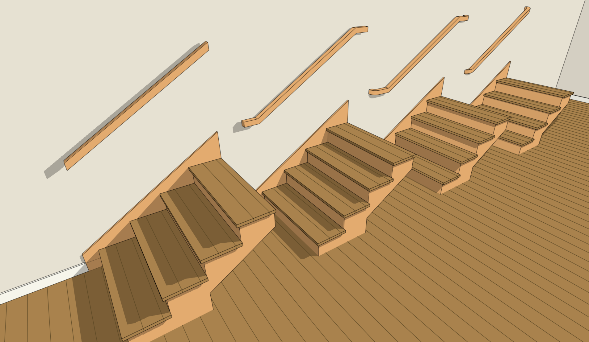

mtldesigns Posted 15 hours ago Share Posted 15 hours ago I've been meaning to ask this for a minute.. As the subject states, in the stair dbx, we have the option to "extend" top end or bottom end. What's the trick, because this has never worked for me? I always, have to model a solid for that void. Or is this something different than I think it is.. which is to extend the railing in either direction. Link to comment Share on other sites More sharing options...
DBCooper Posted 15 hours ago Share Posted 15 hours ago It's pretty basic and will only change the handrail that goes up against a wall. This picture shows a normal railing, one with extensions, one with extensions/returns, and the last one with just returns. Link to comment Share on other sites More sharing options...
mtldesigns Posted 15 hours ago Author Share Posted 15 hours ago Just now, DBCooper said: handrail that goes up against a wall So this has to be up against the wall to work? Where I've noticed where it doesn't work is like steps to a porch post, or floating stairs (what I am working on now, that is not supported by a wall) Link to comment Share on other sites More sharing options...
