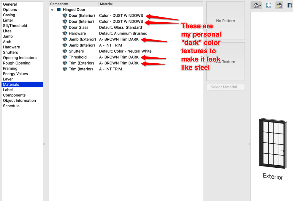

VHampton Posted April 9, 2025 Share Posted April 9, 2025 Chief can make anything. No work-arounds required. Use a glass panel door. Set the frame thickness to the desired slenderness. Steel doors are often no more than a couple of inches. Change the material accordingly. (presumably to dark steel) Please post again in case any of this is unclear. Attached is an example.... Link to comment Share on other sites More sharing options...

Joe_Carrick Posted April 9, 2025 Share Posted April 9, 2025 Cailin, It's not a "Library Door". It's just specified in Chief's "Door Tool" which has settings for almost anything you could want. 2 Link to comment Share on other sites More sharing options...
Solution VHampton Posted April 9, 2025 Solution Share Posted April 9, 2025 4 hours ago, Cailin said: Which library catalog has this glass panel door with narrow stiles/rails? Or is there a place to specify the stiles/rails? Have not been able to find one close. And I'll change the lites to single column w/ 4-5 rows. Thank you! Hi Cailin, Choose a door... and as Joe said, the tools are all there. You're in the driver's seat to make the glass panel door any height, width, thickness, color, and shape that you like. Hope this helps. Kind regards - Val 1 Link to comment Share on other sites More sharing options...
