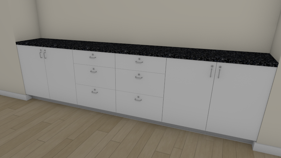

ACADuser Posted July 25, 2024 Share Posted July 25, 2024 Is there a way to add key locks on cabinet doors? Medical office wants the locks shown. Link to comment Share on other sites More sharing options...
DBCooper Posted July 25, 2024 Share Posted July 25, 2024 You could make a custom door symbol that has the lock built in. Just place the door you want in a blank plan, Then place the lock you want and position it where you want. Now convert the whole thing into a new cabinet door symbol. Link to comment Share on other sites More sharing options...
exallspanian34 Posted September 12, 2025 Share Posted September 12, 2025 I've been adding locks manually for years either in elevation to indicate a lock or just adding a basic symbol in 3d (positioning manually)... Hadn't really though about importing a 3d symbol. After thinking about it, I realized you don't have to import a door. You can just stack a lock over a cabinet pull and import it as a hardware symbol, and select use as handle... or even use as lock. Link to comment Share on other sites More sharing options...
