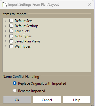

Huey18 Posted March 4, 2022 Share Posted March 4, 2022 I have a house I designed long before I tweaked my process recently. It's a three story house that I'd like to copy or import into a new plan file that is all set-up the way I'd like. So far the only way I've been able to figure out a way to do this is to select everything on each floor in the old plan file, and the paste into a corresponding floor in the new plan file. This does not work well- floor heights and all sorts of things don't end up in the right place. Does anybody know of a good way to import a whole project into a different plan file? Goal here is to update the old design with camera views and plan settings that I've developed in this new file. Thanks! Link to comment Share on other sites More sharing options...

rgardner Posted March 4, 2022 Share Posted March 4, 2022 Depending on what you are looking to accomplish. 1.) Edit>Edit Area>Edit Area (All Floors) copy and paste into new plan, but you will have to set your floor defaults that way (unless you use the import default settings from the old plan assuming it is the same version) 2.) Import your wall types, layer sets, saved plan views, & Default sets from your new file to your old file assuming they are the same version. Link to comment Share on other sites More sharing options...

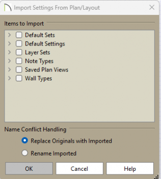

JTECDrafting Posted Tuesday at 03:04 PM Share Posted Tuesday at 03:04 PM File > Import > Import Settings from Plan/Layout > Then select what you want to transfer in. Link to comment Share on other sites More sharing options...
