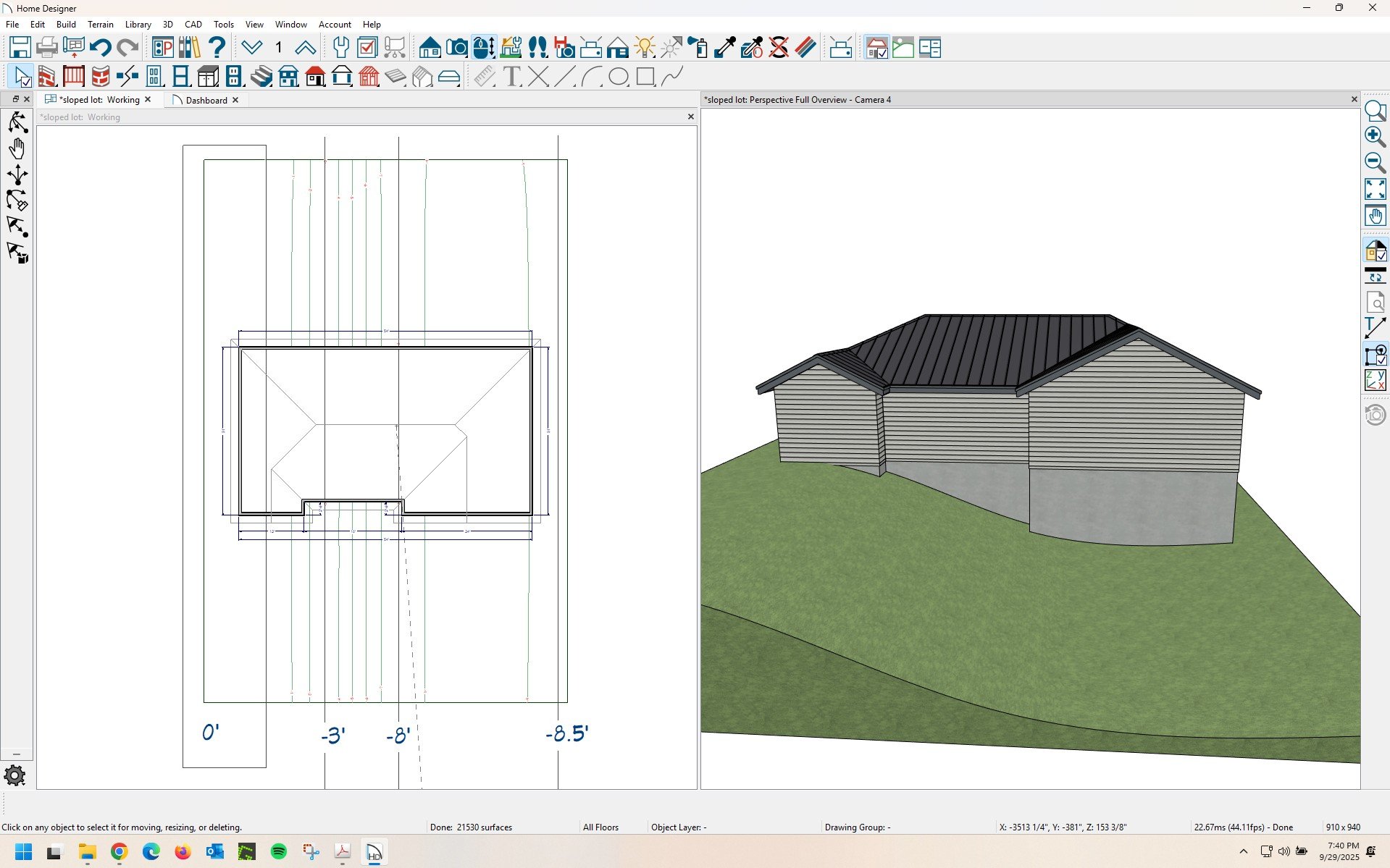

mountaineer Posted June 24, 2016 Share Posted June 24, 2016 Ok. First, I know there are plenty of issues with this plan that I'm still trying to clean up. But, I cannot figure out why I have a piece of floor sticking out of the side of my dormer? I've attached the plan, any input is greatly appreciated. Link to comment Share on other sites More sharing options...
DavidJPotter Posted June 24, 2016 Share Posted June 24, 2016 No plan is attached. DJP Link to comment Share on other sites More sharing options...
mountaineer Posted June 24, 2016 Author Share Posted June 24, 2016 DOH! Sorry, here it is.. Believe in tommorrow 3.plan Link to comment Share on other sites More sharing options...
javatom Posted June 24, 2016 Share Posted June 24, 2016 Your roof is too low. Take a section view of that area and you will see that the baseline of the roof is below the top plate of the lower level. Link to comment Share on other sites More sharing options...
mountaineer Posted June 24, 2016 Author Share Posted June 24, 2016 Ah! Thank you! I know I shouldn't be using auto roof. This is the first time I've seen this. Thank you for your help. I'm still learning so sometimes I still hit a wall. Link to comment Share on other sites More sharing options...
