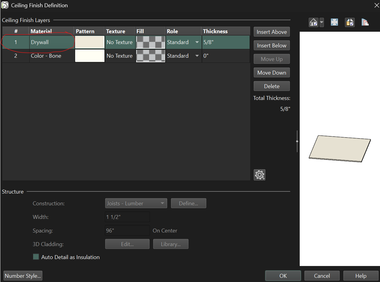

KilianDrafting Posted Tuesday at 01:24 PM Share Posted Tuesday at 01:24 PM Is there a macro that can return the material name on a specific ceiling finish layer in a room? The room ceiling finish macro only gives the exposed "color-bone" as the ceiling finish. Link to comment Share on other sites More sharing options...
Solution PitMan71 Posted Tuesday at 01:37 PM Solution Share Posted Tuesday at 01:37 PM Does this help? %room.ceiling_finish_layers[0].material_data.description% Change the 0 to 1 for the next layer. I tried this in my room label and it worked. Link to comment Share on other sites More sharing options...
KilianDrafting Posted Tuesday at 02:08 PM Author Share Posted Tuesday at 02:08 PM 29 minutes ago, PitMan71 said: Does this help? Yes Sir! Thanks so much! Link to comment Share on other sites More sharing options...
