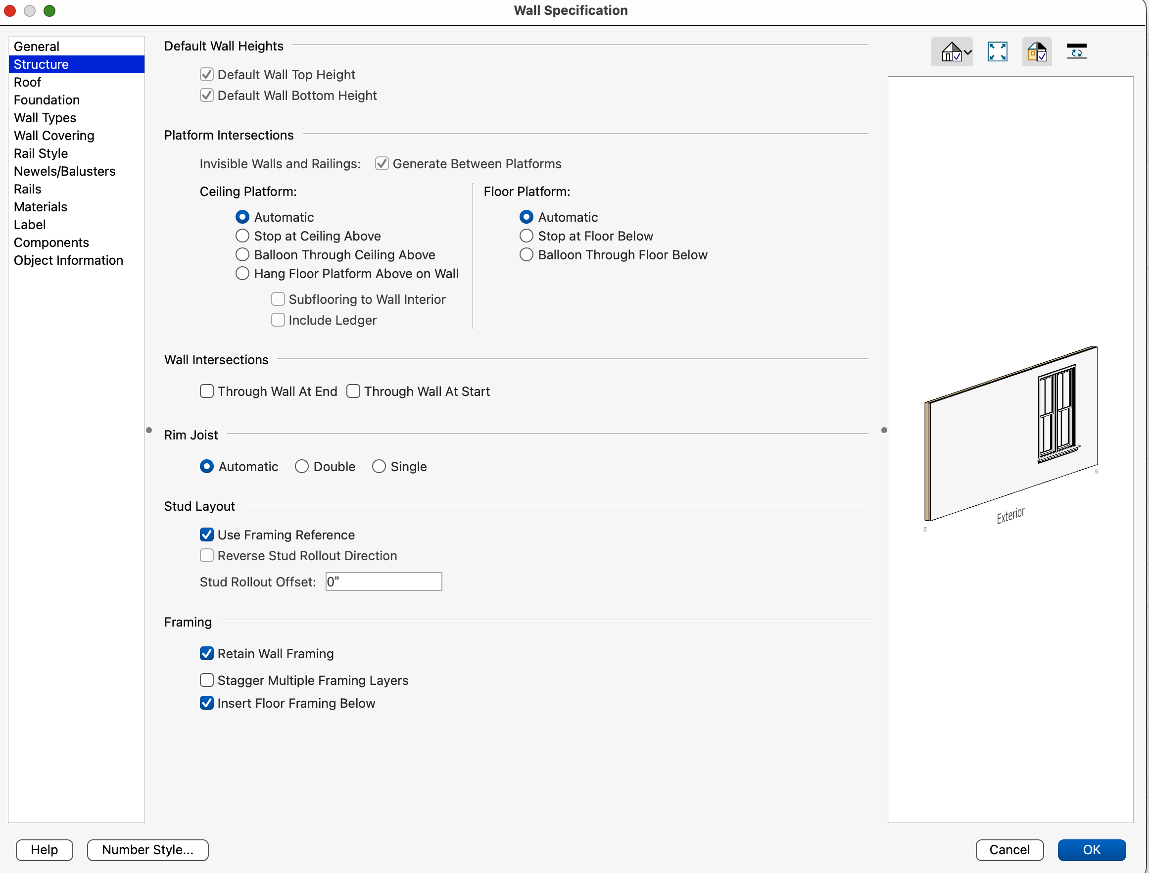

BeachGirl Posted August 18 Share Posted August 18 I am using Home Designer Pro 2025 and cannot find the DOUBLE WALL - Furred Wall as an option as outlined in the instructions for creating furred walls. I am trying to take a double wall - exterior wall and interior basement wall and marry them so that window and door openings show up correctly. Link to comment Share on other sites More sharing options...

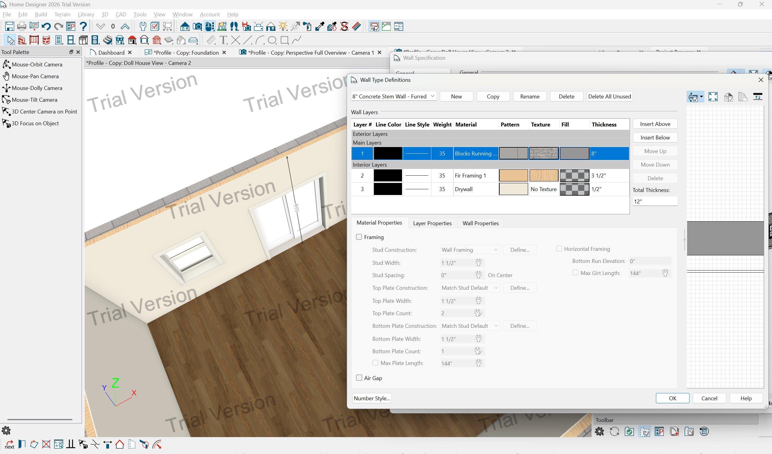

Garybills Posted August 19 Share Posted August 19 @BeachGirlI don't think that option is available even in HDP 2026, You can make a wall type with CMU or concrete, 2 x 4 stud and drywall. Link to comment Share on other sites More sharing options...
BeachGirl Posted August 19 Author Share Posted August 19 According to the Chief/Architect/Home Designer site is was available starting in 2021 for Home Designer Pro. Link to comment Share on other sites More sharing options...
Dermot Posted August 19 Share Posted August 19 As far as I know, no version of Home Designer or Home Designer Pro has ever had the "Double Wall" features that are in Chief Architect Premier (on the Structure panel of the Wall Specification dialog or the Casing panel of the Window or Door Specification dialogs). Home Designer Pro 2025 should have the ability to create custom Wall Types where you can have both a concrete layer and a framing layer to create a manual furred wall. You may be able to get more help from other Home Designer Pro users on the HomeTalk user forum here: https://hometalk.chiefarchitect.com/ Link to comment Share on other sites More sharing options...
