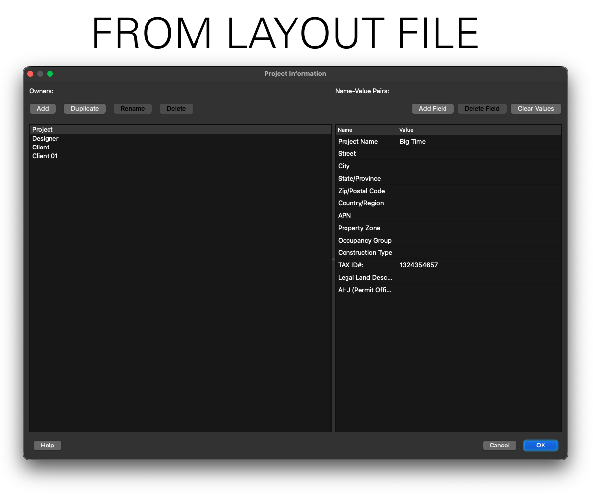

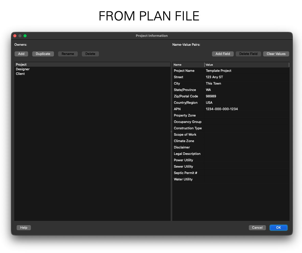

para-CAD Posted yesterday at 02:26 AM Share Posted yesterday at 02:26 AM (edited) This might be cool. The Project Information feature in the layout file is an independent project information tool as compared to the Project Information tool in the plan file. This opens up all kinds of interesting things beyond where I can even think they might be useful knowing that I could have layout-specific project information versus plan-specific project information and since we can create our own fields, this can be extremely powerful. Edited yesterday at 02:34 AM by para-CAD 1 Link to comment Share on other sites More sharing options...
Joe_Carrick Posted 23 hours ago Share Posted 23 hours ago (edited) You might also note that since the Layout and the Plan are separate - Macros in them are also separate. So you can have a macro in each with the same name but totally different script and result. My Layout files have only 25 macros and only 6 or 7 are duplicated in the Plan file. OTOH, my Plan files have over 175 macros. Edited 23 hours ago by Joe_Carrick 1 Link to comment Share on other sites More sharing options...
