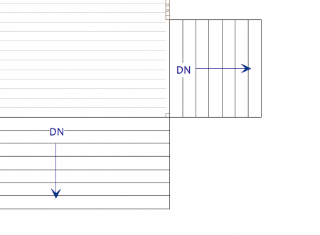

James_H Posted July 29 Share Posted July 29 I'm trying to miter these two deck stair sections at a 45 degree angle. I've reviewed all videos for something helpful and can't find anything. Has anyone done this or something similar? Thanks Link to comment Share on other sites More sharing options...
DBCooper Posted July 30 Share Posted July 30 In your picture, it looks like it should work. Make sure both stairs have "allow wrap" checked. Make sure both stairs are the same length. Make sure that both stairs have the same top and bottom heights. Other than that, you might need to post the plan or contact tech support. Link to comment Share on other sites More sharing options...
