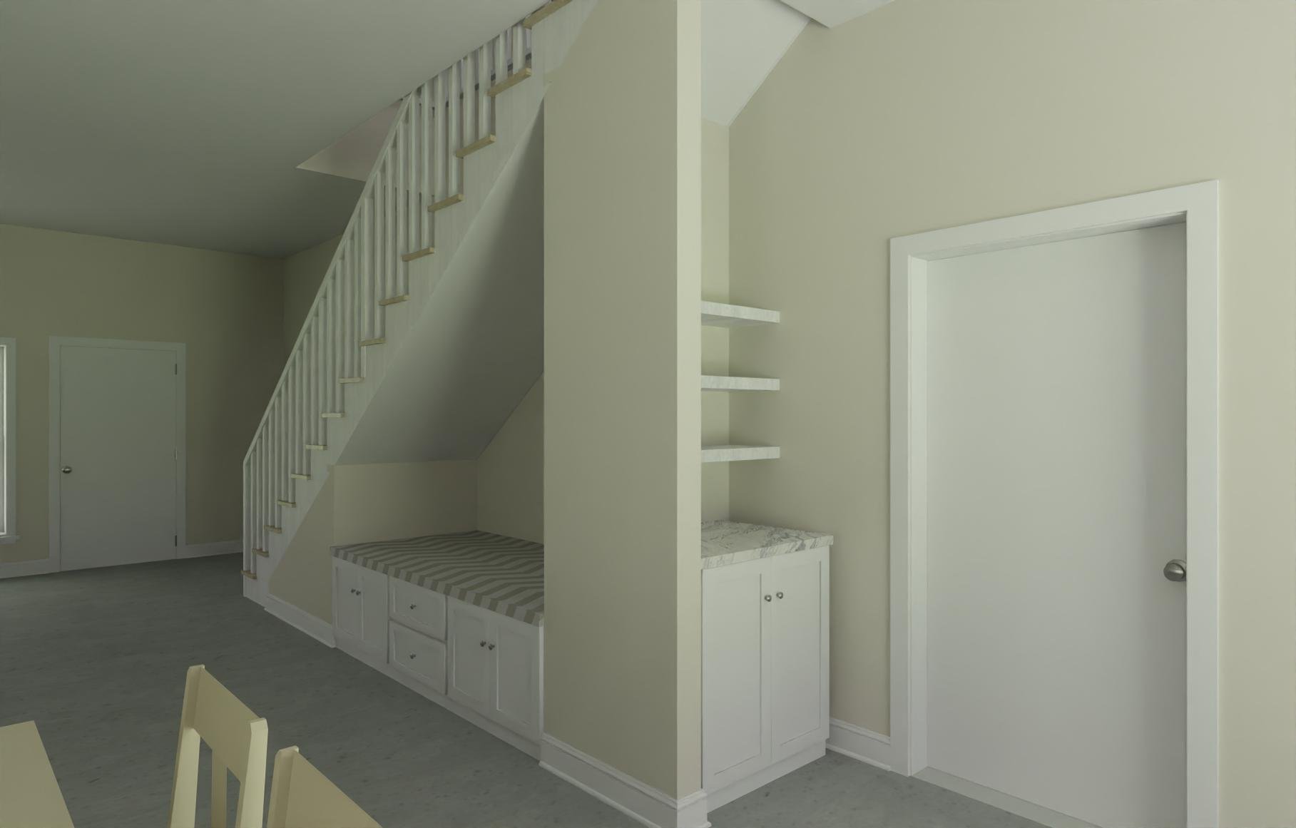

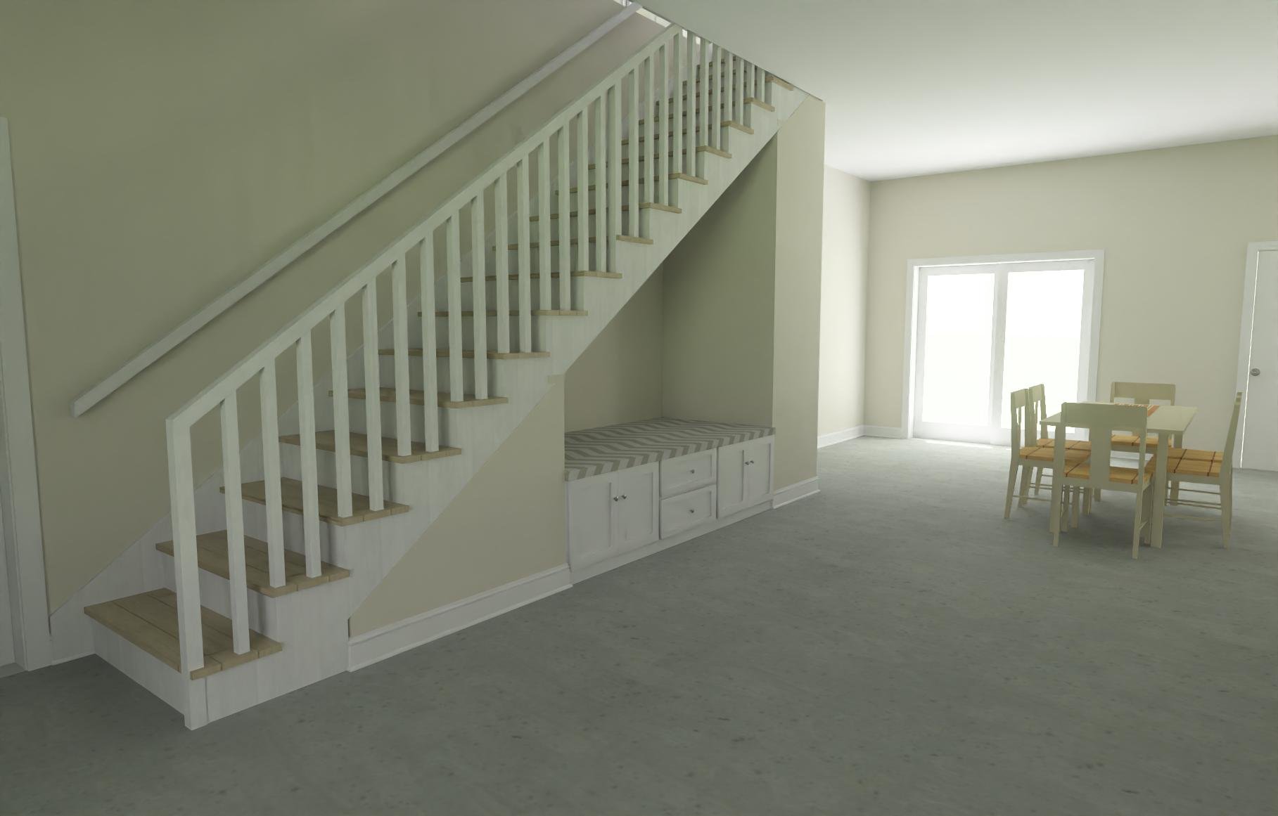

winterdd Posted July 28 Share Posted July 28 (edited) Here is one I have in work.....base cabinets are the way to go..........and walls under stairs to form the enclosure. Client wants a space to lie down and read books. I gave him 7' of cushioned area. Edited July 28 by winterdd 3 Link to comment Share on other sites More sharing options...
KBEDesign Posted July 28 Author Share Posted July 28 @winterdd This is exactly what I'm going for! How did you get the base cabinet to insert into the walls? I have drawn the wall under the stairs, but I can't get the base cabinets to set into the walls. Link to comment Share on other sites More sharing options...
Renerabbitt Posted July 28 Share Posted July 28 49 minutes ago, KBEDesign said: @winterdd This is exactly what I'm going for! How did you get the base cabinet to insert into the walls? I have drawn the wall under the stairs, but I can't get the base cabinets to set into the walls. He only drew the walls where he needed them. There are no walls where the cabinets are You may have bumps turned off, either turn off bumps and place your cabinet or hold the ctrl key when moving your cabinets to override bumps 1 Link to comment Share on other sites More sharing options...
KBEDesign Posted July 28 Author Share Posted July 28 @RenerabbittThank you! 1 Link to comment Share on other sites More sharing options...
winterdd Posted July 28 Share Posted July 28 I need to dress mine up but it got the point across I see. Glad between all the answers here it helped you. Link to comment Share on other sites More sharing options...
