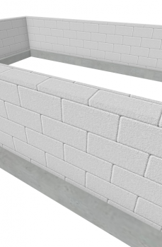

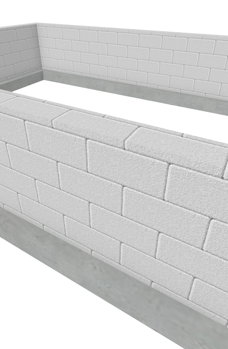

Randino Posted July 15 Share Posted July 15 Seems like a silly question, but it's bothering me. Why doesn't the wall start with a full block on top of the footer and why is it slightly wider that 1 block? using the default 8" CUM (Block) Stem wall thickness is 7 5/8" Thanks in advance Link to comment Share on other sites More sharing options...
Chrisb222 Posted July 15 Share Posted July 15 3 hours ago, Randino said: Why doesn't the wall start with a full block on top of the footer Because the wall is using a randomly assigned repeating pattern to represent the blocks, not stacking actual individual blocks like you would irl. You can force it to look how you want, mostly, with some work. Need to adjust the material and pattern offsets in the Define Material dialog, or by using the Interactive Material Editor. You may possibly need to create copies with different adjustments to get it to look how you want. See if this Knowledge Base article helps: https://www.chiefarchitect.com/support/article/KB-00194/changing-the-direction-of-a-material-s-pattern-and-texture.html 1 Link to comment Share on other sites More sharing options...
Randino Posted July 15 Author Share Posted July 15 Thank you. That works. This works just like applying wood grain in other 3d graphic programs I've used.. I mistakenly though these were individual block. ( I don't know what I was thinking) Thanks again for your help and quick response Link to comment Share on other sites More sharing options...
