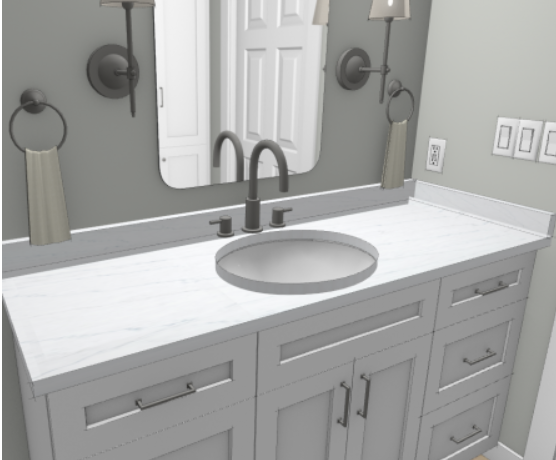

GSDesign Posted July 1 Share Posted July 1 I just loaded Chief 17 onto a new laptop and the undermount sinks in vanities are appearing to be surface mounted when I shoot perspectives. Any suggestions on what setting may be off? Please let me know! I've tried numerous different sinks but all render with this raised shadow line with and without toggling shadows. Thank you for any ideas to fix this! -Deb Link to comment Share on other sites More sharing options...
Michael_Gia Posted July 1 Share Posted July 1 (edited) looks undermount to me but it's as if your counter is semitransparent? It you look towards the faucets it's clearly undermount but then around front I'm seeing through the counter at the cut-out edge. Edited July 1 by Michael_Gia Link to comment Share on other sites More sharing options...

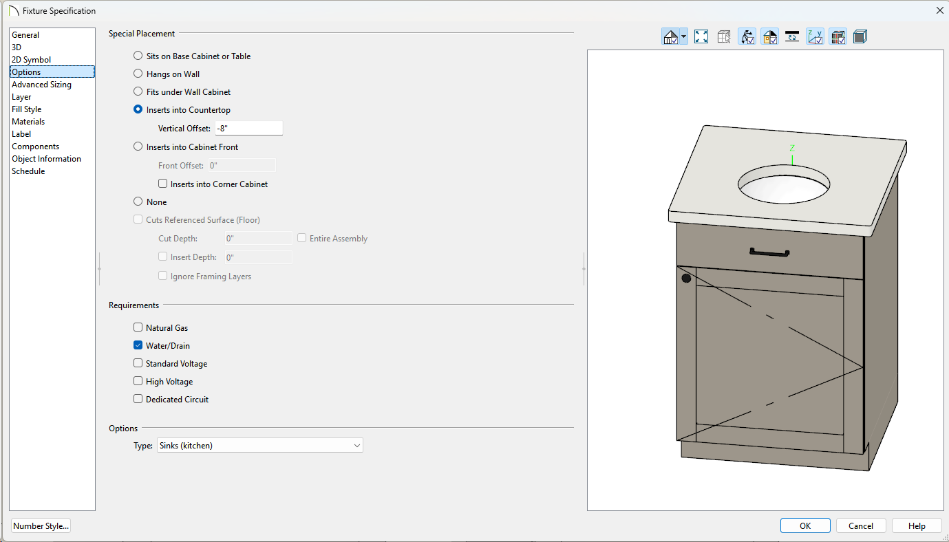

DBCooper Posted July 1 Share Posted July 1 Open the sink dialog and make sure it is set to "inserts into countertop" and the vertical offset is set appropriately. If this doesn't help, then you should probably post your plan. Link to comment Share on other sites More sharing options...
GSDesign Posted July 1 Author Share Posted July 1 Thank you both!!! I changed to a different countertop material and it looks better- so strange. Not sure why that quartz was reading as transparent but that seems to be the issue. Link to comment Share on other sites More sharing options...
