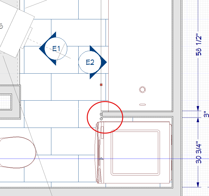

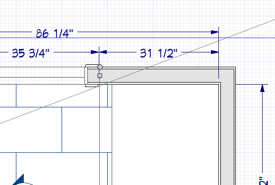

MYNORFOLK Posted Monday at 04:54 PM Share Posted Monday at 04:54 PM Hi, I do a lot of bathroom designs. When i create a shower stall. I need to specify where the tile will end on the wall. I use a room divider sometimes instead of a glass shower wall. Usually because i am trying to control where the tile and base molding starts/ends. But the room divider always snaps to interior or exterior of the side walls. I am hoping there is a way to change this. thank you for your help and suggestions. My info: HP Z BOOK FURY 16 G10 MOBILE WORKSTATION PC WINDOWS 11 32 G. RAM 13TH GEN. INTEL (R) CORE TMI9-13950HX 12G GRAPHICS CARD Nancy Link to comment Share on other sites More sharing options...
javatom Posted Monday at 07:04 PM Share Posted Monday at 07:04 PM Place a wall break in the framed wall where you want the room divider to snap to. Link to comment Share on other sites More sharing options...
Joe_Carrick Posted Monday at 07:47 PM Share Posted Monday at 07:47 PM This is very common problem. Maybe X18 will have a solution. Link to comment Share on other sites More sharing options...
