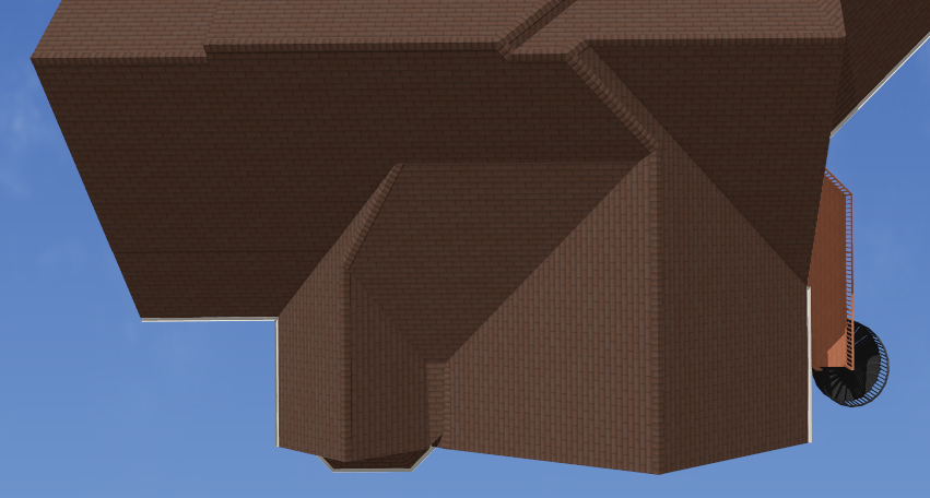

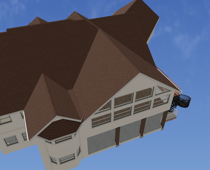

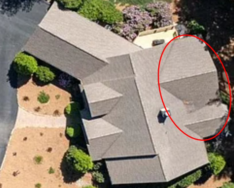

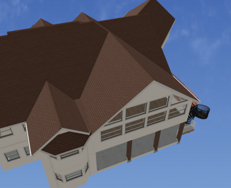

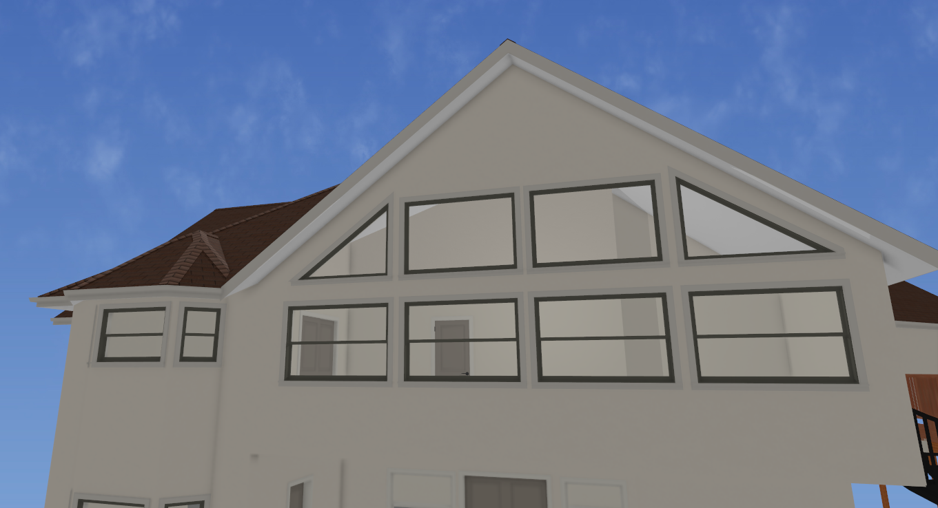

I would like to create this house in Chief Architect: 2026-05-20 11.07.22.jpg69018280_Screenshot2026-06-03085727.thumb.png.0a96dedd2d12c98b8bcea5d379454f82.png
My boss told me I have to do it with only Auto Roofs because he is not sure if he gave me the correct dimensions so we may need to update it later.

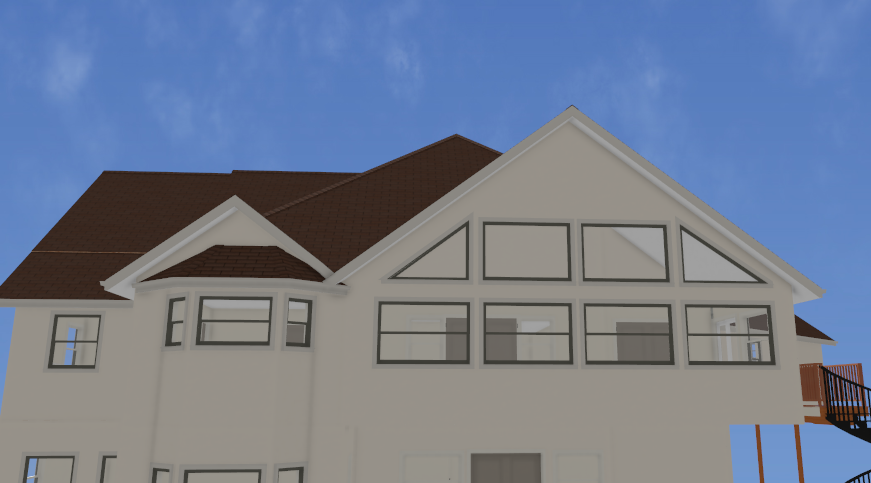

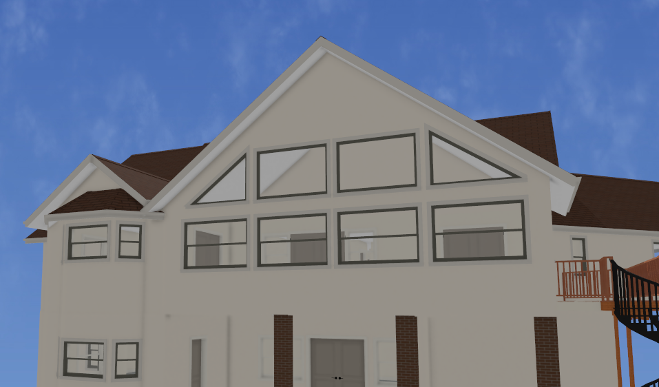

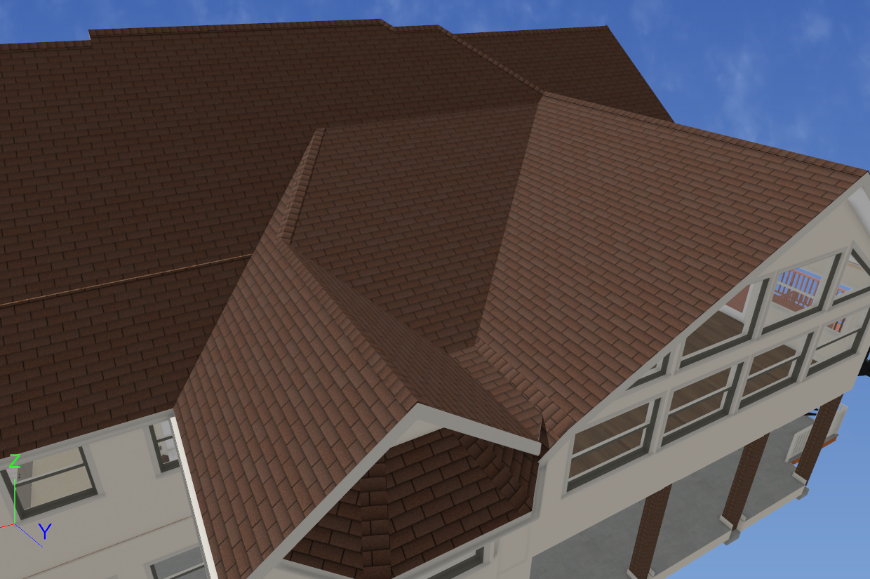

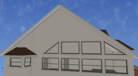

So far I have constructed the large gable: image.thumb.png.baa7144ee02c72186cda5ee8d1bcfd20.png

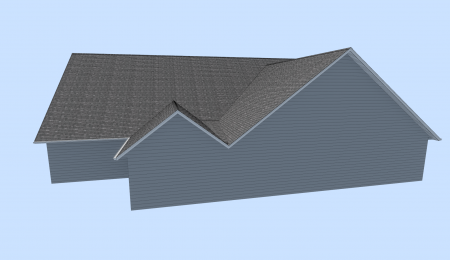

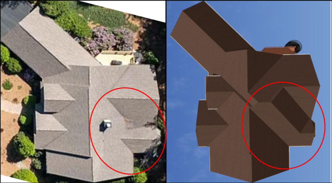

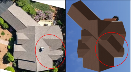

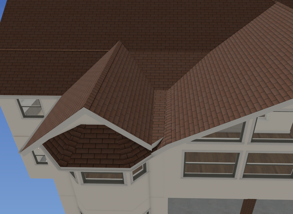

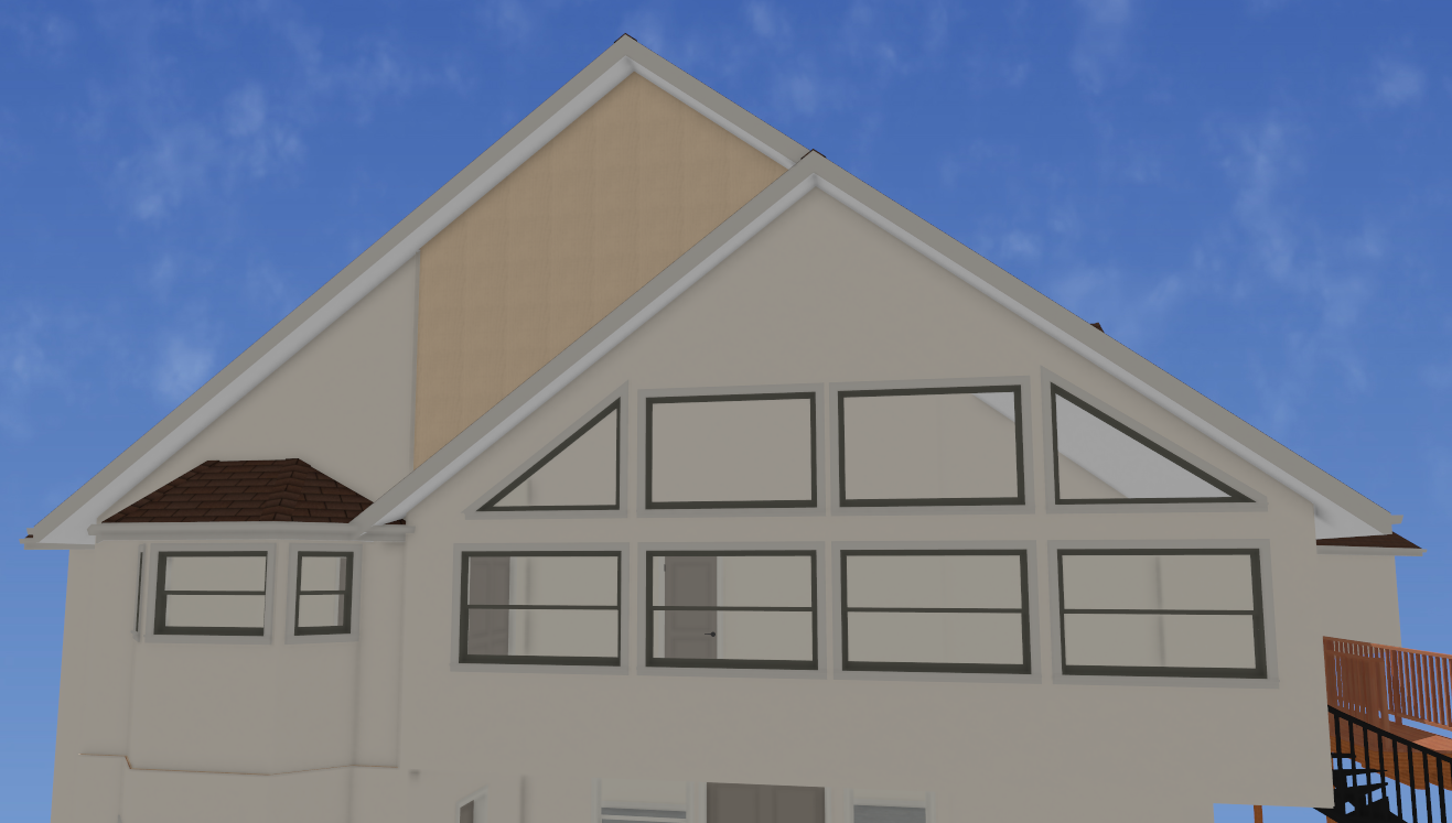

But when I try to add the smaller gable on the side, it creates a double gable:image.thumb.png.11989c7a7d9ad48c0b64732bd105c07e.png

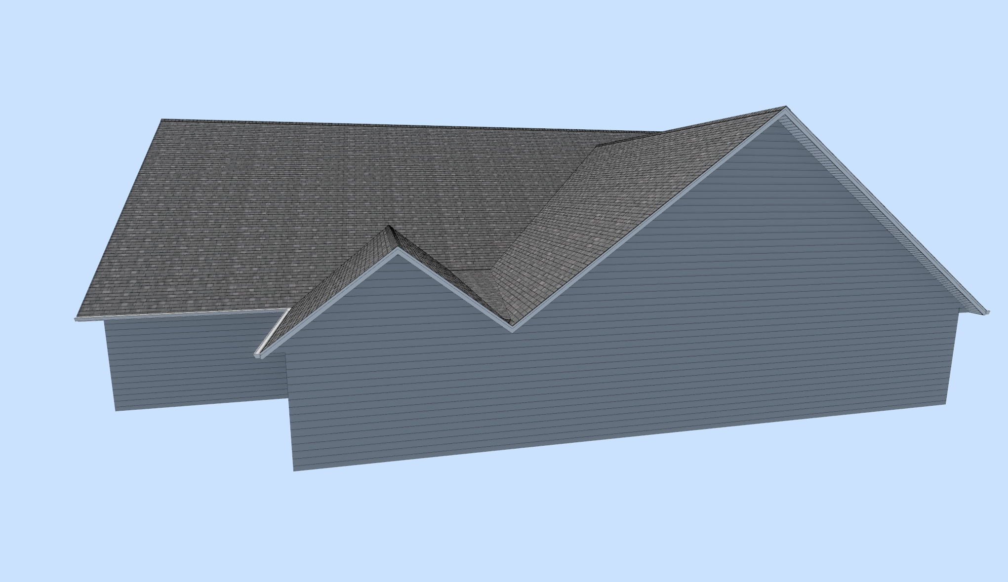

Or it creates one big gable: image.thumb.png.1c4347b93f43f62f37f60acaef9e5839.png
Does anyone have any ideas for how to fix this with only using Auto Roofs?

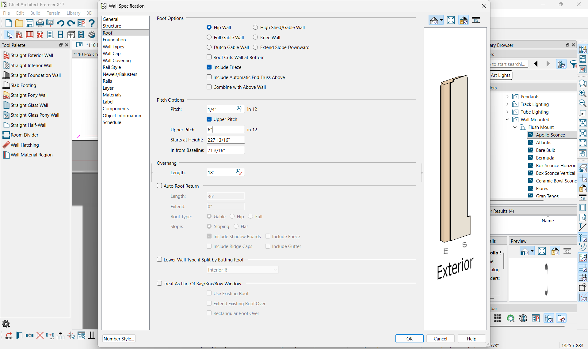

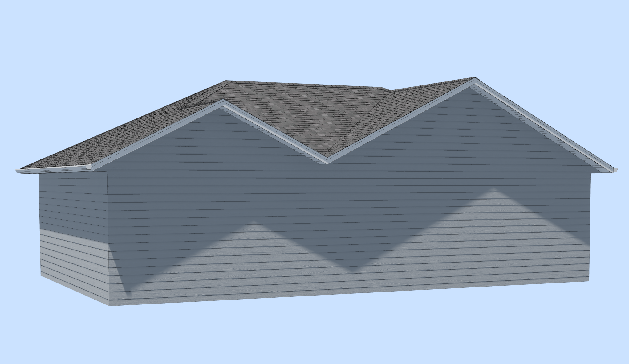

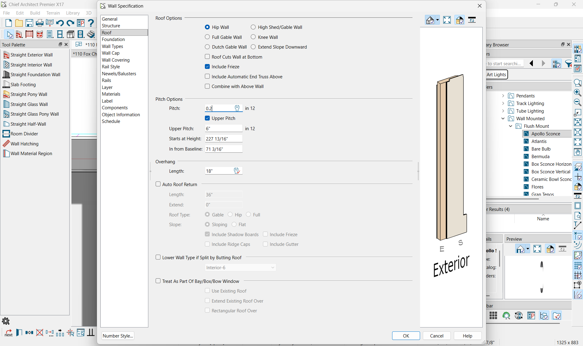

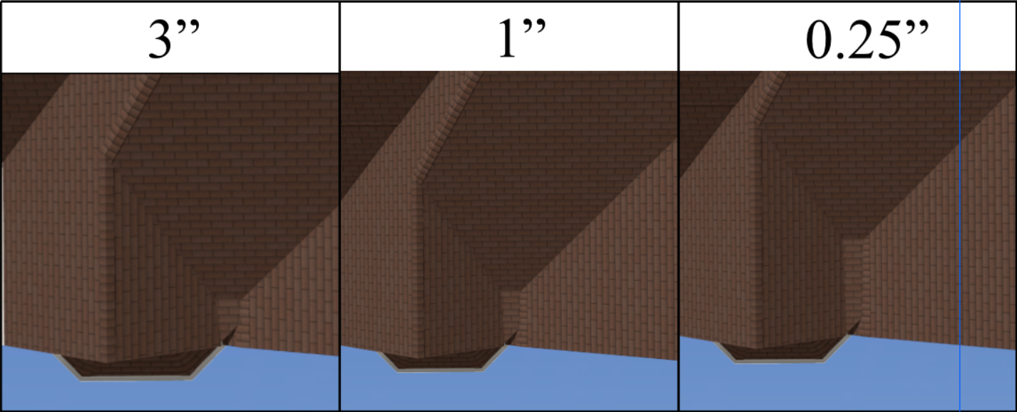

Whew...with auto is gnarly.  Maybe break a little 3"-6" section and change that little section to hip?
I would definitely draw it manual...not sure why you would HAVE to draw it auto.  It would be easier to change down the road doing it all manual anyways.
 EDIT:
Just tested it, and it needs to be a 6" chunk.
