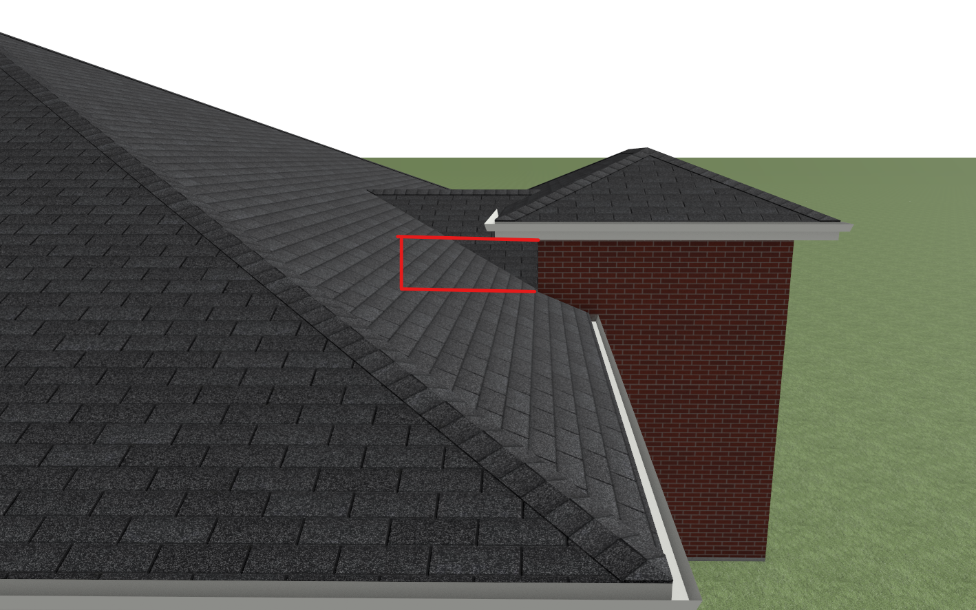

Jonathan3891 Posted May 14 Share Posted May 14 (edited) Hello everyone, I’ve run into a scenario that I can’t seem to find the best solution for. In the attached plan, I have a front porch with a raised ceiling to achieve a taller exterior appearance. The ceiling itself is flat, just higher than the surrounding ceilings. The issue I’m running into is getting the attic walls shown in the screenshot below to generate properly where the raised porch roof ties into the main roof. I’ve tried rebuilding roofs and checking the wall/room definitions, but I still can’t seem to get those attic walls to generate correctly. Also, is there a good way to handle this setup while still utilizing automatic roofs, or is this one of those situations where manual roof planes are the better approach? Any advice would be appreciated. Working.plan Edited May 14 by Jonathan3891 Forgot attachement Link to comment Share on other sites More sharing options...
Mark3D Posted May 14 Share Posted May 14 Does that get you what you need, check attached file I just finished it with manual roof. Working.plan Link to comment Share on other sites More sharing options...
