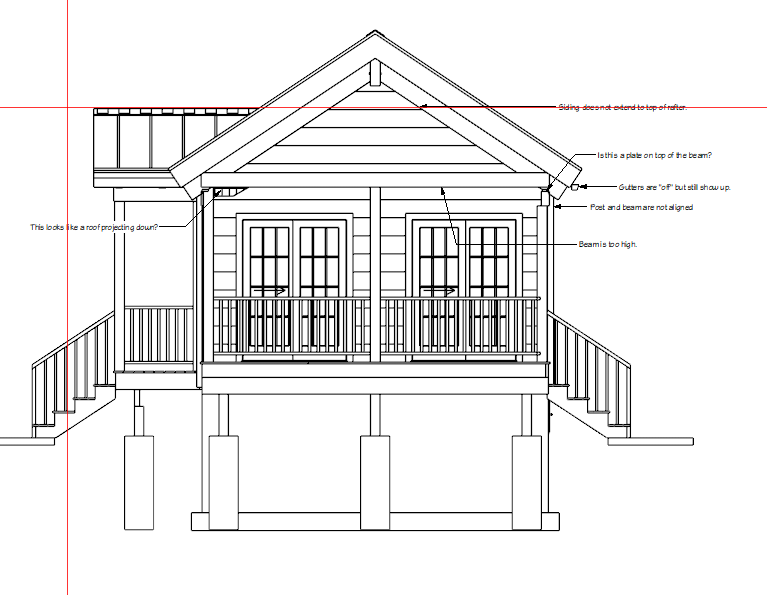

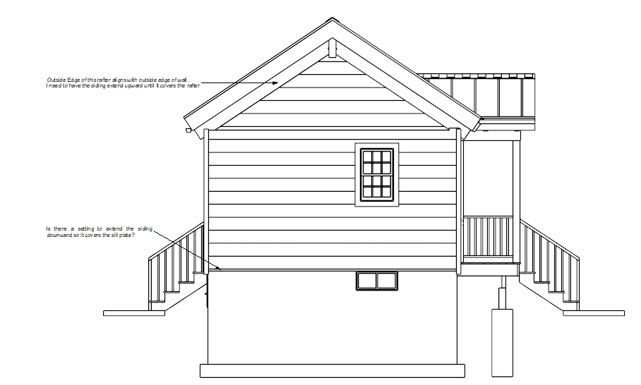

Ed_Orum Posted Monday at 04:05 PM Share Posted Monday at 04:05 PM (edited) 1. How can I get the log siding to extend upwards so it covers the rafter? 2. How do I lower the gable wall railing beam? Currently it projects into the roof. 3. A few other issurs on the 2nd screenshot. Screenshots attached. Zip file attached. Thanks in advance, Lane Cozy Cabin Plan File For Zipping.zip Edited Monday at 05:25 PM by Ed_Orum Attached Zip file Link to comment Share on other sites More sharing options...
PitMan71 Posted Monday at 09:33 PM Share Posted Monday at 09:33 PM You will need to draw walls in the attic manually above those gables and contour them manually. In the elevation add a break point in the middle. Then pull the middle and the sides down. Link to comment Share on other sites More sharing options...
PitMan71 Posted Monday at 09:35 PM Share Posted Monday at 09:35 PM Delete the gutter from the roof object and that will take care of the gutters. Link to comment Share on other sites More sharing options...

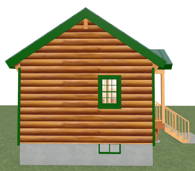

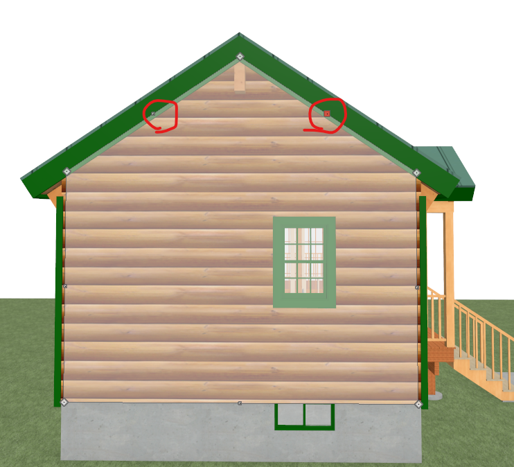

Solution builtright3 Posted Tuesday at 12:18 AM Solution Share Posted Tuesday at 12:18 AM I changed the wall to a baloon wall and then drug the handles up where I wanted the log to stop. Took me about 20 seconds. 1 Link to comment Share on other sites More sharing options...
Ed_Orum Posted Tuesday at 10:52 AM Author Share Posted Tuesday at 10:52 AM That does it. Thanks! Link to comment Share on other sites More sharing options...
builtright3 Posted Tuesday at 02:00 PM Share Posted Tuesday at 02:00 PM 3 hours ago, Ed_Orum said: That does it. Thanks! I was able to fix most of it. I wasn’t sure what was causing the issue with the railing walls on the porch, so I went ahead and rebuilt them from scratch. Would you like me to send the file back with my updates? Also, it looks like you were running into the same issue I recently learned about. I had to turn off “Auto Rebuild Attic Walls” in the defaults—this setting can really cause problems on custom builds. Link to comment Share on other sites More sharing options...
builtright3 Posted Tuesday at 02:13 PM Share Posted Tuesday at 02:13 PM I don’t think you needed to make that wall a balloon wall to get it up to the roof sheathing. It looks like the issue was tied to the “Auto Rebuild Attic Walls” setting. Once that’s turned off, you should be able to draw those walls in manually and have better control without needing to use a balloon wall. Link to comment Share on other sites More sharing options...
