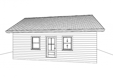

Chief-007 Posted April 20 Share Posted April 20 Hello everyone, I am on Chief x17 working on elevations when I ran into an issue regarding Opening Indicators. Is there a reason opening indicators are not available for rendering techniques other than vector view? I read a different discussion suggesting to use the line overlay option, but I am not familiar with that. Does someone in here have a quick video on how to use the "line overlay" option and have my opening indicators show in my "Hand Drawn Lines" Rendering Technique? Thanks in advance. Link to comment Share on other sites More sharing options...

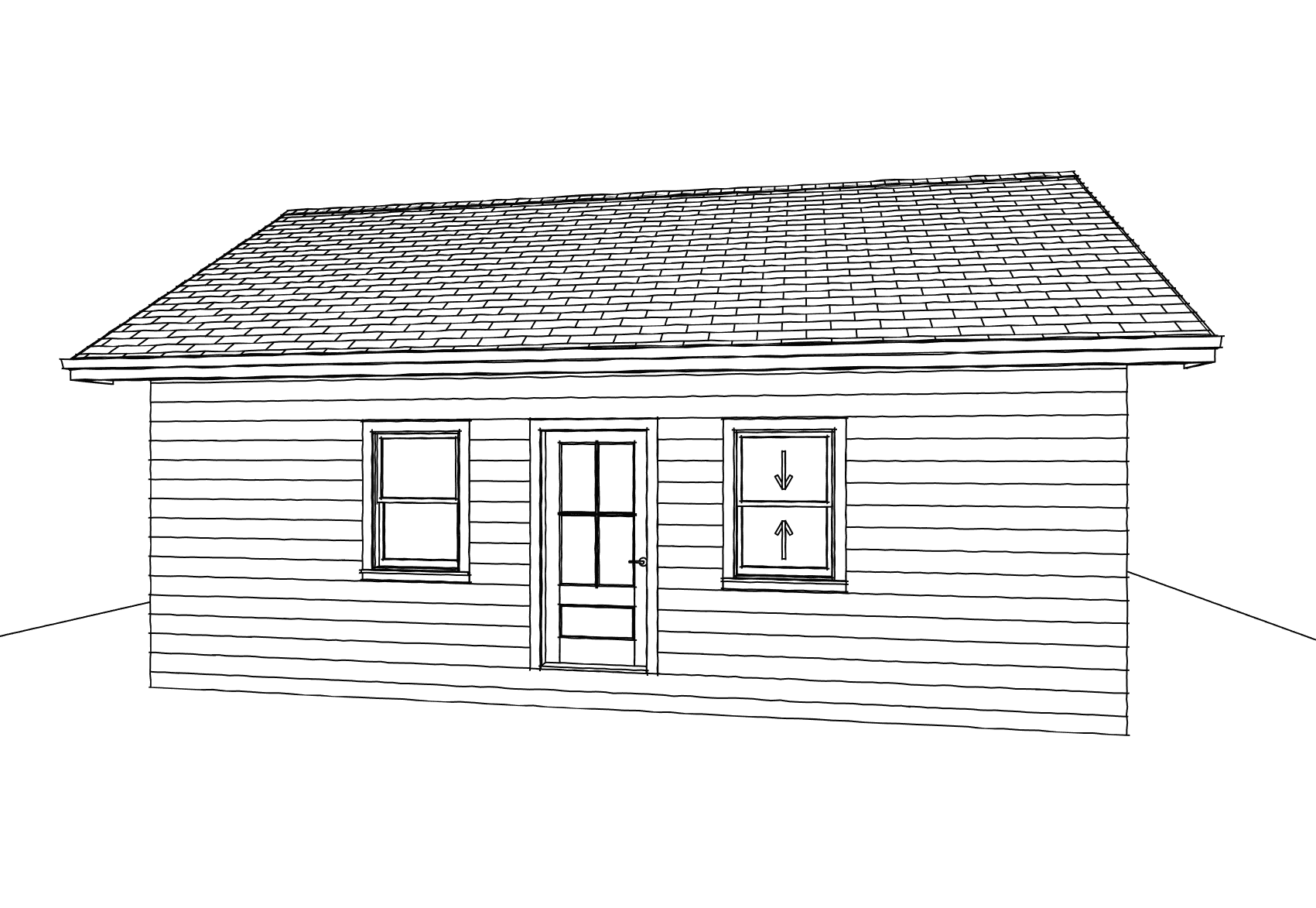

MPDesign Posted April 21 Share Posted April 21 I am afraid vector view is the only camera, you could make arrows with 3d solids if needed. Save them to your library for reuse. The image is hand drawn lines camera. Link to comment Share on other sites More sharing options...
