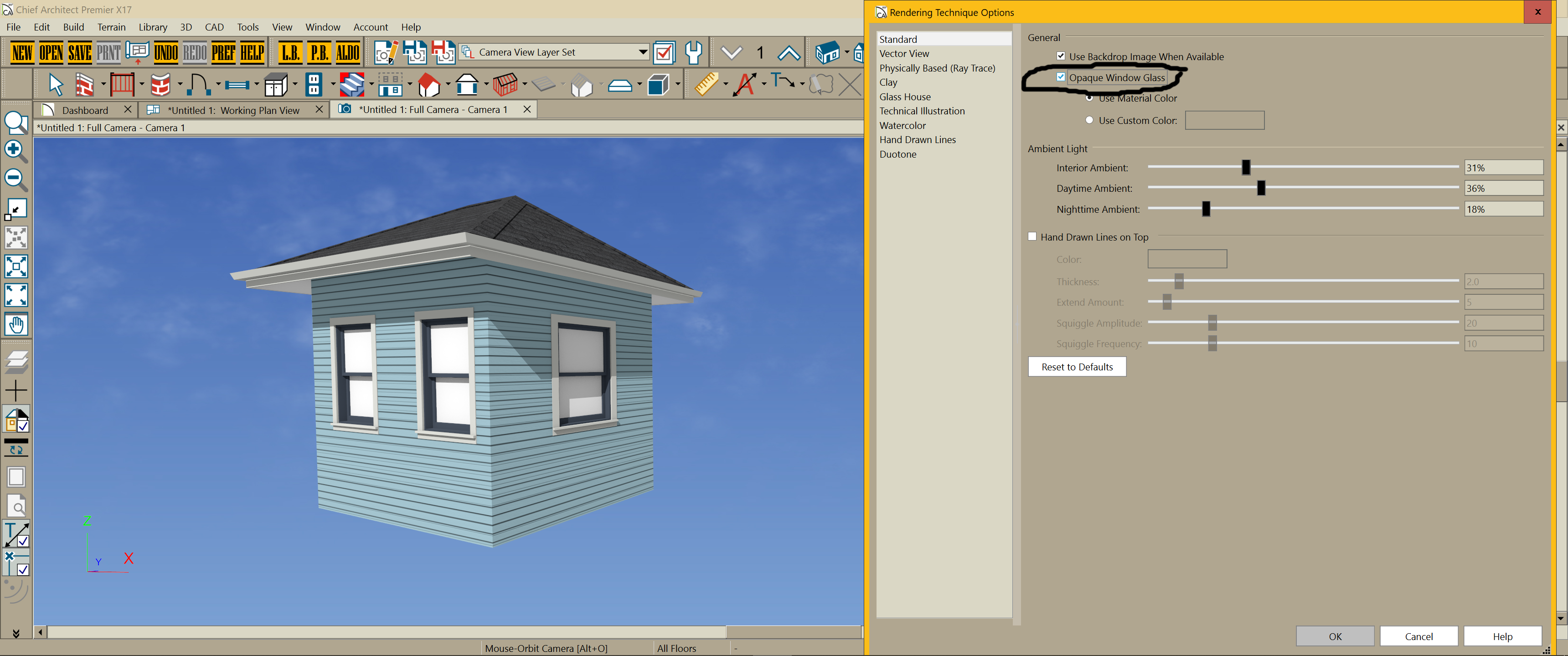

mikesbarn Posted 15 hours ago Share Posted 15 hours ago This one has me. Somewhere in along the process my Transparent Glass went to white. I copied the material to my personal folder open the file and made sure it was set for transparancy Link to comment Share on other sites More sharing options...
SHCanada2 Posted 12 hours ago Share Posted 12 hours ago (edited) went to white where? screenshot? the plan? Edited 12 hours ago by SHCanada2 Link to comment Share on other sites More sharing options...
Rich_Winsor Posted 4 hours ago Share Posted 4 hours ago What type of camera view are you using? For every type of rendering technique except Physically Based and Glass House there is an option to have Opaque Window Glass. Check the Rendering Technique Options to see if that option is checked. Link to comment Share on other sites More sharing options...
