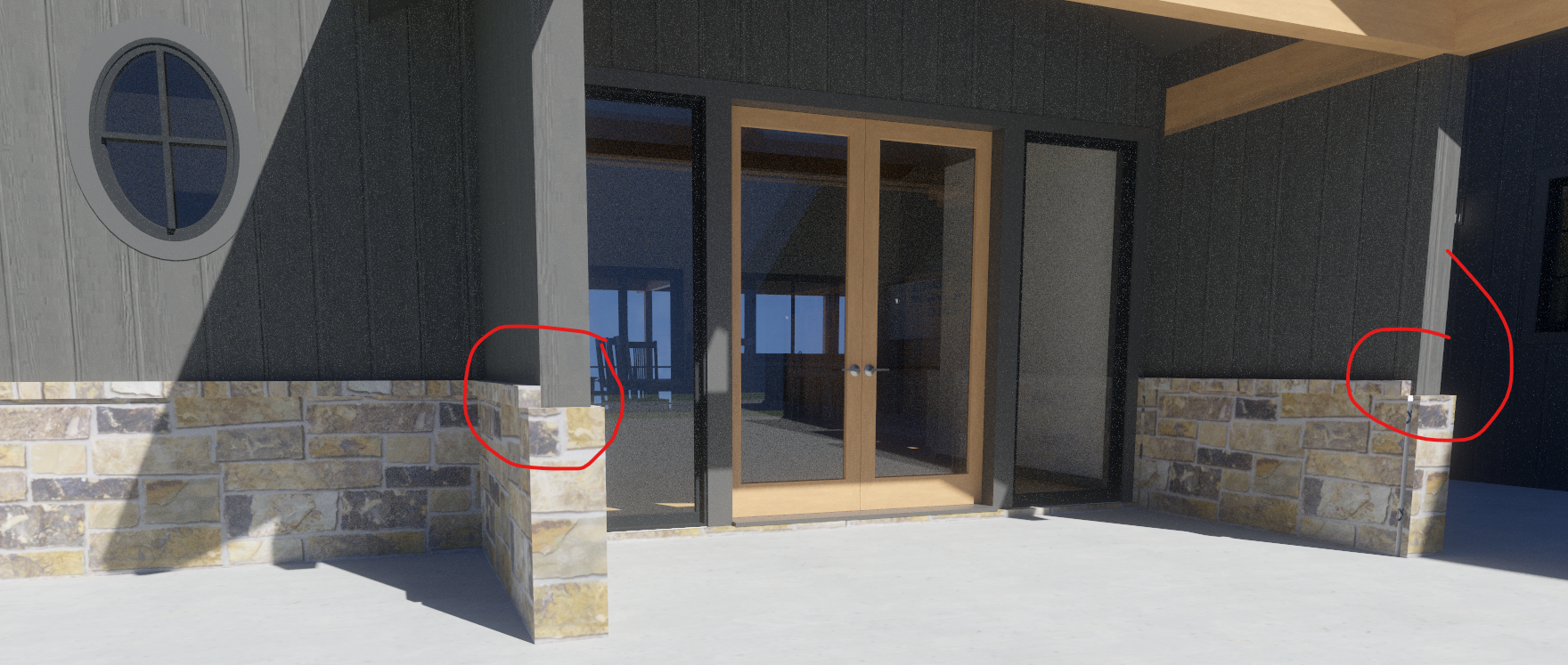

AbeLopez Posted 3 hours ago Share Posted 3 hours ago Hi, I'm trying to extend my stone cap, can't seem to find that option. Any ideas? Thanks Link to comment Share on other sites More sharing options...
mtldesigns Posted 2 hours ago Share Posted 2 hours ago (edited) @AbeLopez Looks like a good spot for a 3d solid. End of walls like you have here, with I am assuming a wall that is invisible perpendicular, does sometimes cause these caps to not come in. Edited 2 hours ago by mtldesigns Link to comment Share on other sites More sharing options...
