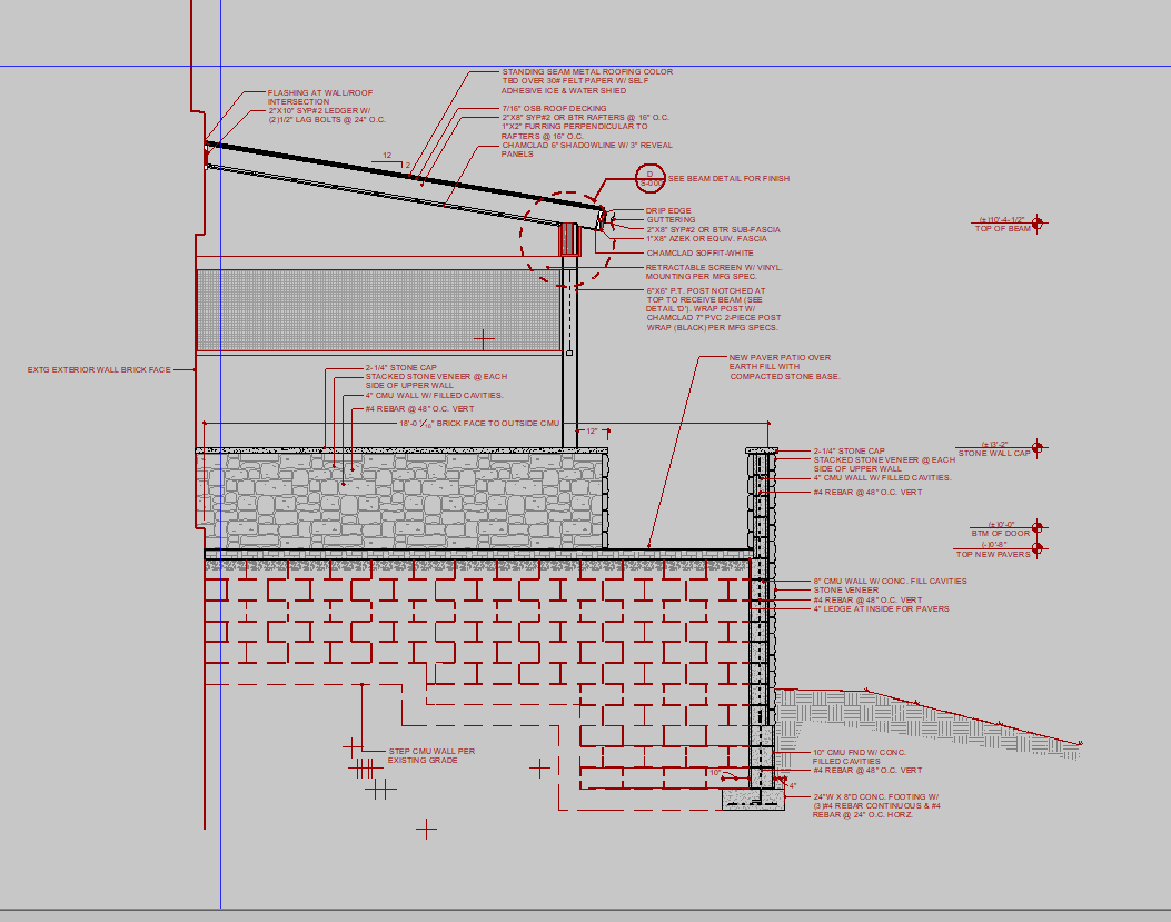

joey_martin Posted 1 hour ago Share Posted 1 hour ago Have I missed an update or patch? What's with the tick marks all over my CAD details? Link to comment Share on other sites More sharing options...
JKEdmo Posted 35 minutes ago Share Posted 35 minutes ago 34 minutes ago, joey_martin said: Have I missed an update or patch? What's with the tick marks all over my CAD details? Yes, there was a forum discussion about this not too long ago: Link to comment Share on other sites More sharing options...
