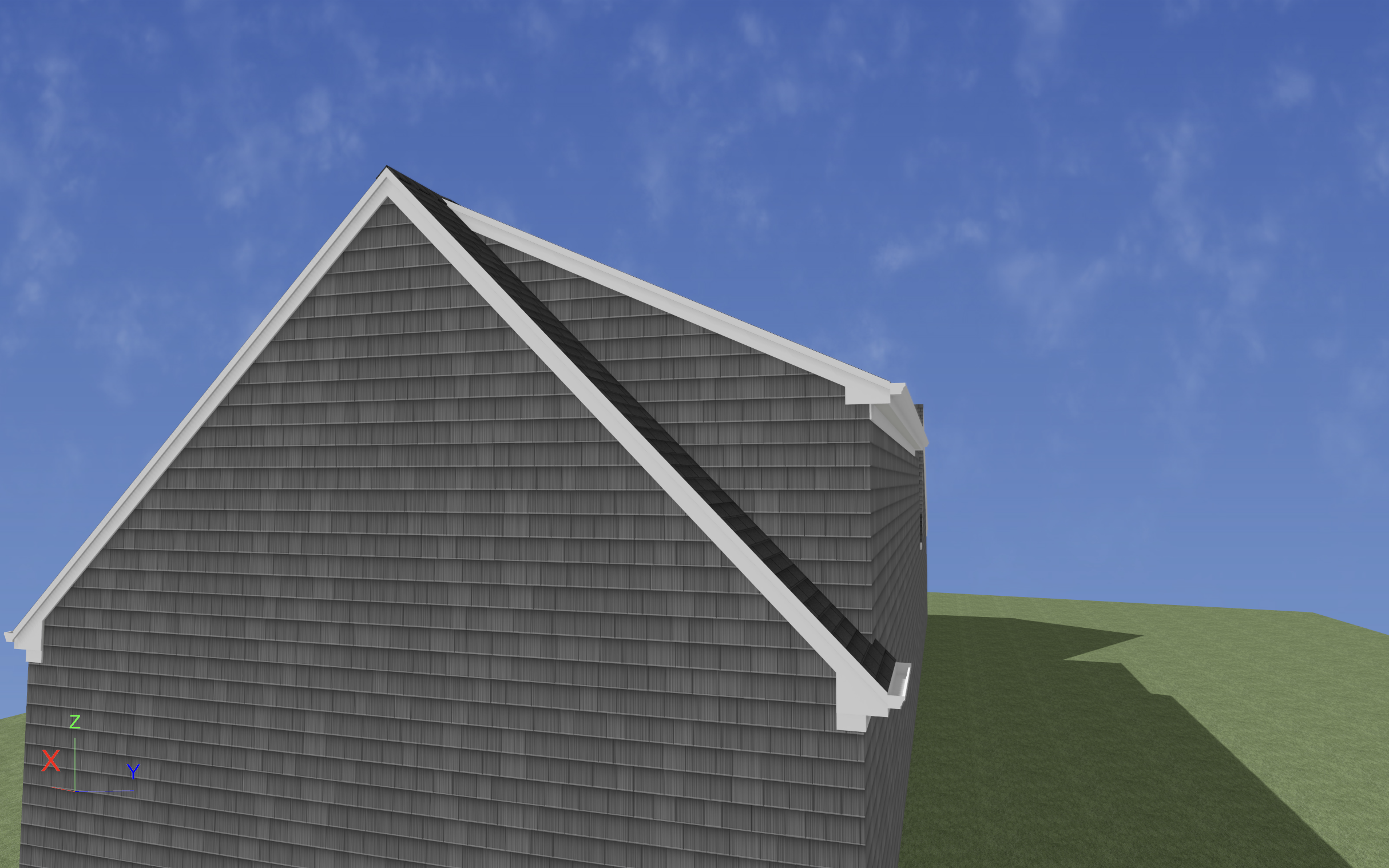

Skip_D Posted 3 hours ago Share Posted 3 hours ago Hi, This is a regular issue I have. Sometimes it works fine, other times not. I have no idea why. As you can see, the dormer end wall is not showing the siding. It's not reversed and it shows fine inside. Any thoughts? thanks, George X17 gable pic.pdf dormer question.plan Link to comment Share on other sites More sharing options...

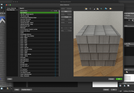

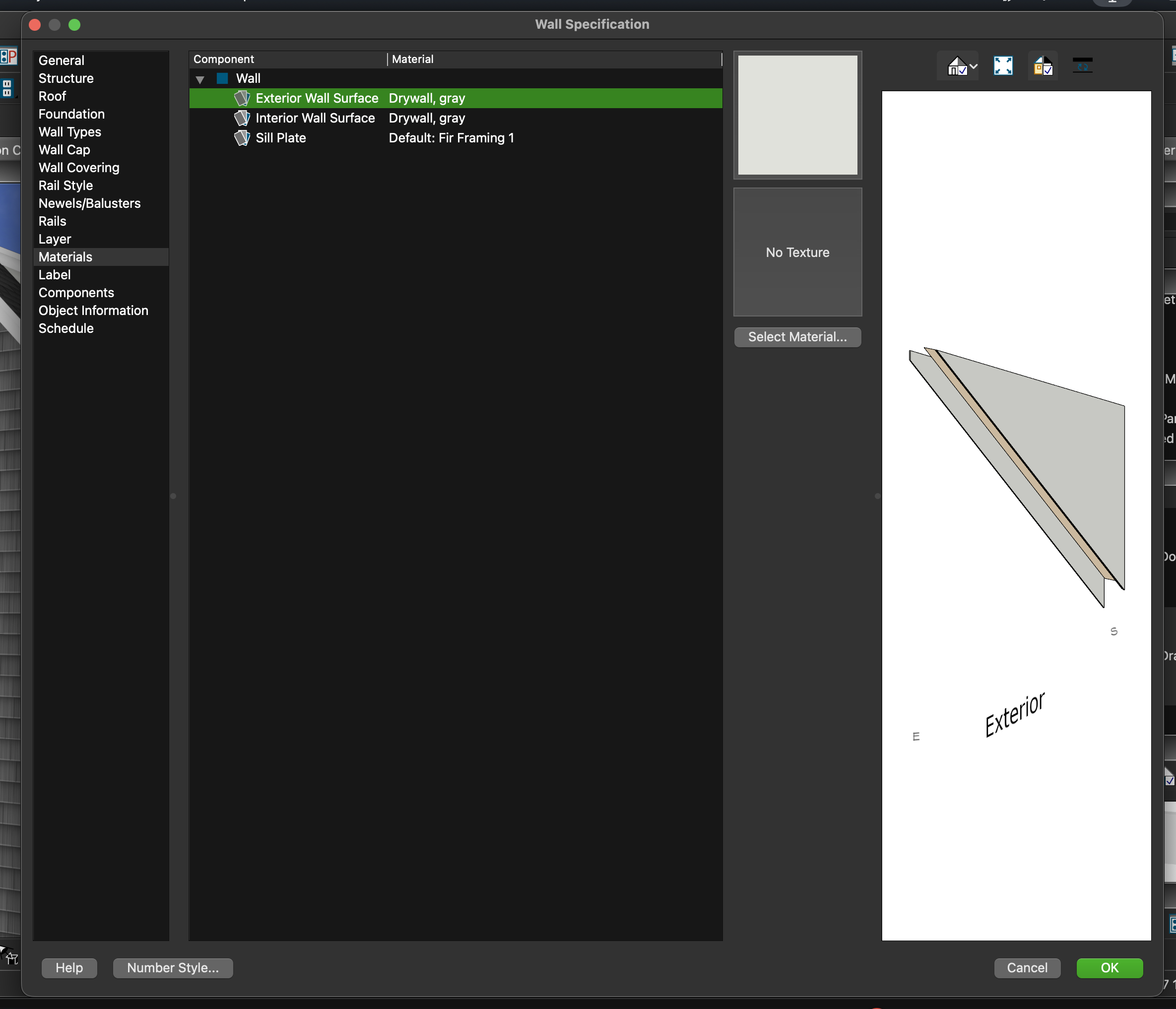

Solution Rosco2017 Posted 3 hours ago Solution Share Posted 3 hours ago It looks like you've "painted" the exterior material. Go into the wall definition's material tab and change the exterior material back to default. Link to comment Share on other sites More sharing options...

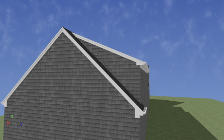

Rosco2017 Posted 3 hours ago Share Posted 3 hours ago I've attached your plan. 1677830231_dormerquestion FIXED.plan Link to comment Share on other sites More sharing options...
