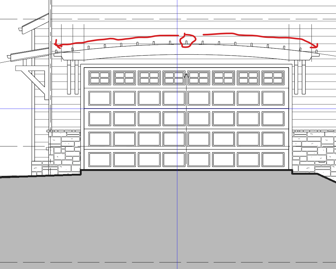

JKEdmo Posted March 3 Share Posted March 3 Good afternoon, I'm building a curved pergola and want to distribute some purlins radially across the top of the shaped / curved beam below: Is a radial copy even possible with Chief? If so, could someone point me towards a video or forum thread that explains the process please? I had trouble finding this. Thanks again, Jim Link to comment Share on other sites More sharing options...

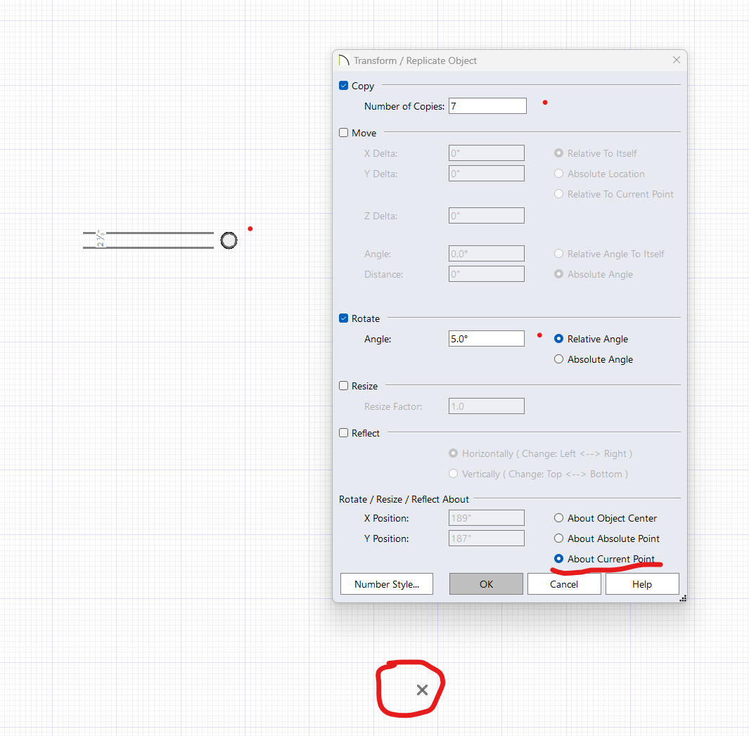

JiAngelo Posted March 4 Share Posted March 4 Jim, Place a point at your radius center. Select the object you wish to copy, choose "About current point", select # of copies, and specify an angle, If you don't like the results, CNTRL Z and repeat, choose a different +/- radius to get the spacing right and number of copies needed. You can start from one side, but I generally start in the middle then mirror the results when I get the angle set to spacing it how I want. Hope this helps. 1 Link to comment Share on other sites More sharing options...

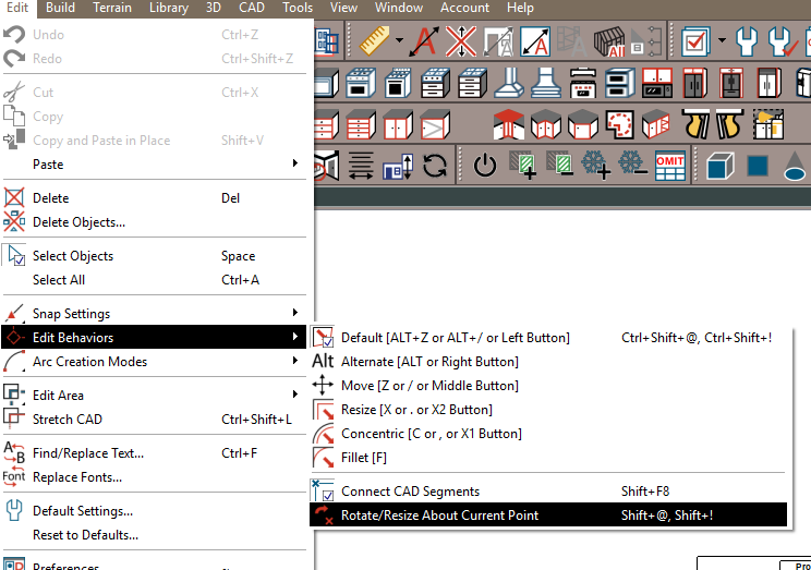

Renerabbitt Posted March 4 Share Posted March 4 7 hours ago, JKEdmo said: Thanks John for your reply. I'll give it a try! You can also use multiple copy with this checked: which requires a point 1 Link to comment Share on other sites More sharing options...

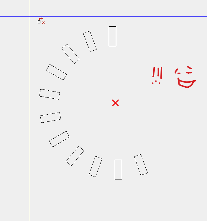

JKEdmo Posted March 5 Author Share Posted March 5 1 hour ago, Renerabbitt said: You can also use multiple copy with this checked: which requires a point Thank you. Got it to work! Link to comment Share on other sites More sharing options...
