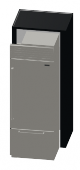

dhurst Posted February 25 Share Posted February 25 Can anyone help me with inserting built-in (Sub-zero) refrigerator into a tall cabinet. For some reason since switching to X17, the refrigerator sits in front of the cabinet . Link to comment Share on other sites More sharing options...

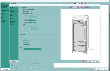

MollyNDG Posted February 25 Share Posted February 25 The way fixtures insert into cabinet faces has changed in X17. If you open up the cabinet -> Front/Sides/Back -> Appliance and select Edit you can adjust the amount the fixture inserts into the Cabinet Front (Options, Select Inserts into Cabinet Front and enter a value). 1 1 Link to comment Share on other sites More sharing options...
