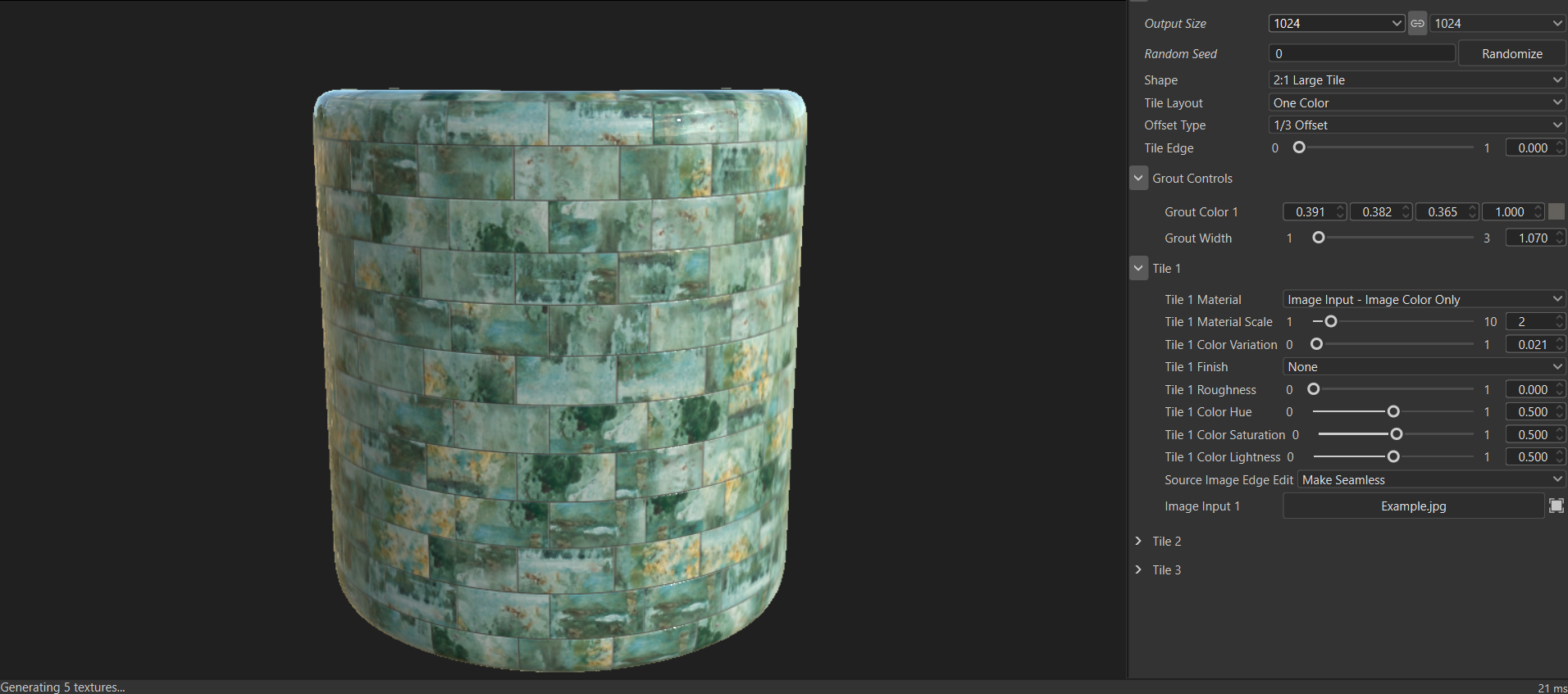

CADustin Posted March 3 Share Posted March 3 Hey Gen, looks like good guy Rene got you covered, but for next time, you can use the tile builder to make these kinds of materials. You need two things... -A seamless image of the material used to make the tile. We want all the tile lines removed so its just a slab of material for the builder to slice up into tile. -The Tile Builder, found in Chief X17 or above, or the external Tile Builder found here... https://chieftalk.chiefarchitect.com/topic/21560-custom-material-generation-with-substance-player/ For your seamless image, you can either use photoshop to remove all the tile/grout lines or use AI to do it for you to get something like this. From there you plop it into the tile builder with these settings to get pretty close to your target tile. From here you can tinker till it matches your individual taste. Good luck! let me know if you hit any snags if you try it. 1 Link to comment Share on other sites More sharing options...
