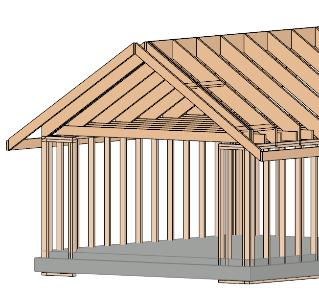

jacpdx Posted February 21 Share Posted February 21 Hi, I cannot figure out why, when I create my foundation, it does not get placed below the framing (see pic). I am a relatively new user trying to add a slab with footing foundation to a detached garage plan. I have checked everything, but I am clearly missing something. Any advice would be greatly appreciated. Thanks, John Link to comment Share on other sites More sharing options...

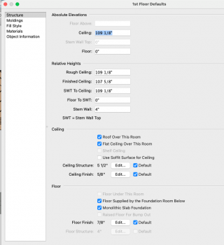

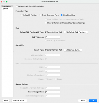

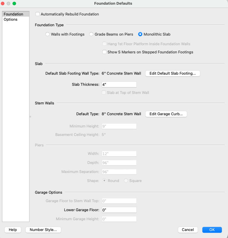

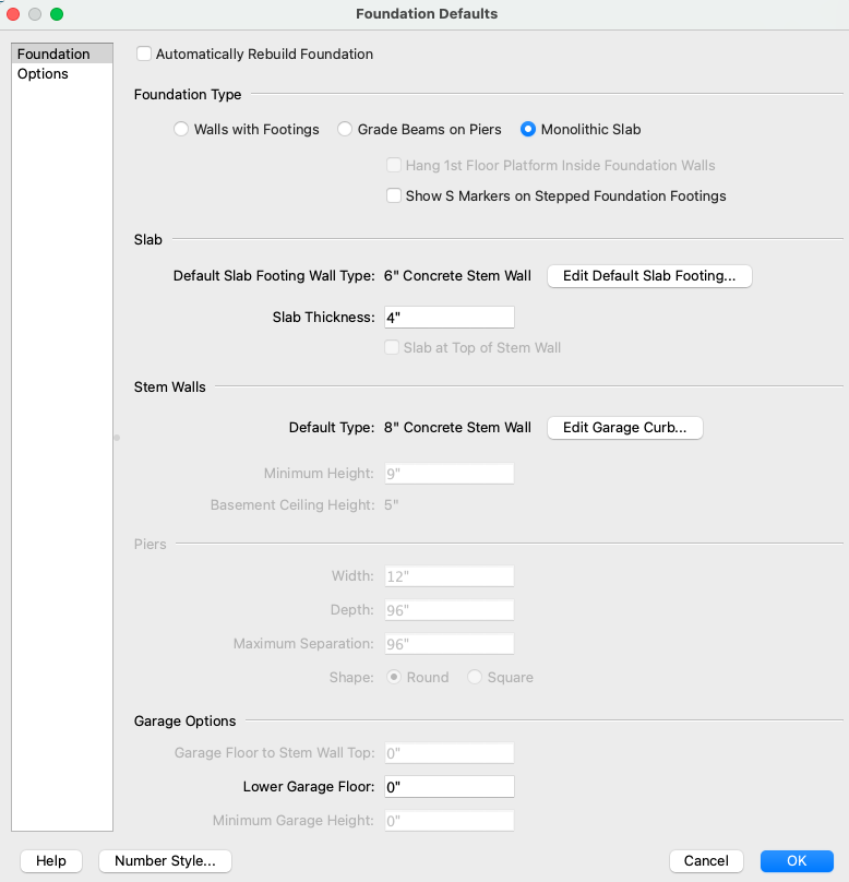

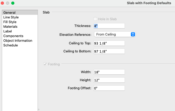

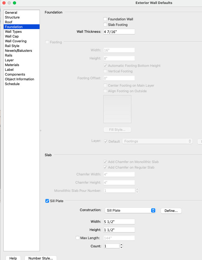

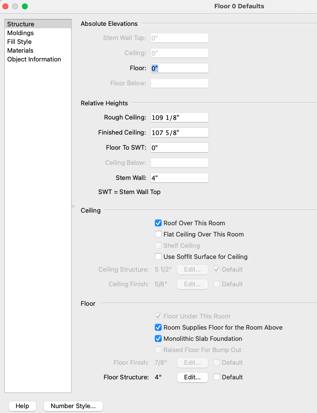

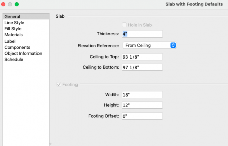

jacpdx Posted February 21 Author Share Posted February 21 (edited) Hi Mark, I used the Build Foundation tool. Here are screenshots from the default panel. Edited February 21 by jacpdx Link to comment Share on other sites More sharing options...
Solution CharlesVolz Posted February 22 Solution Share Posted February 22 Simple: 1. Post the plan. 2. Rebuild your framing. 3. Post the plan. 1 Link to comment Share on other sites More sharing options...
jacpdx Posted February 22 Author Share Posted February 22 oh man, thank you, Charles... Rebuilding the framing did it. Newbie lesson learned :-) 1 Link to comment Share on other sites More sharing options...
