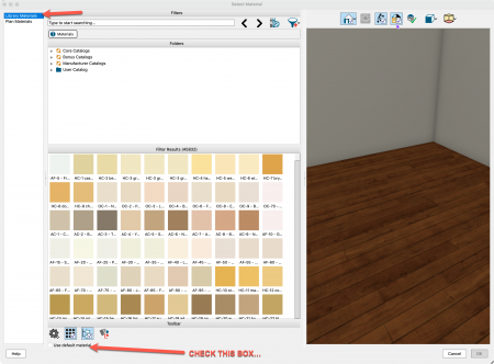

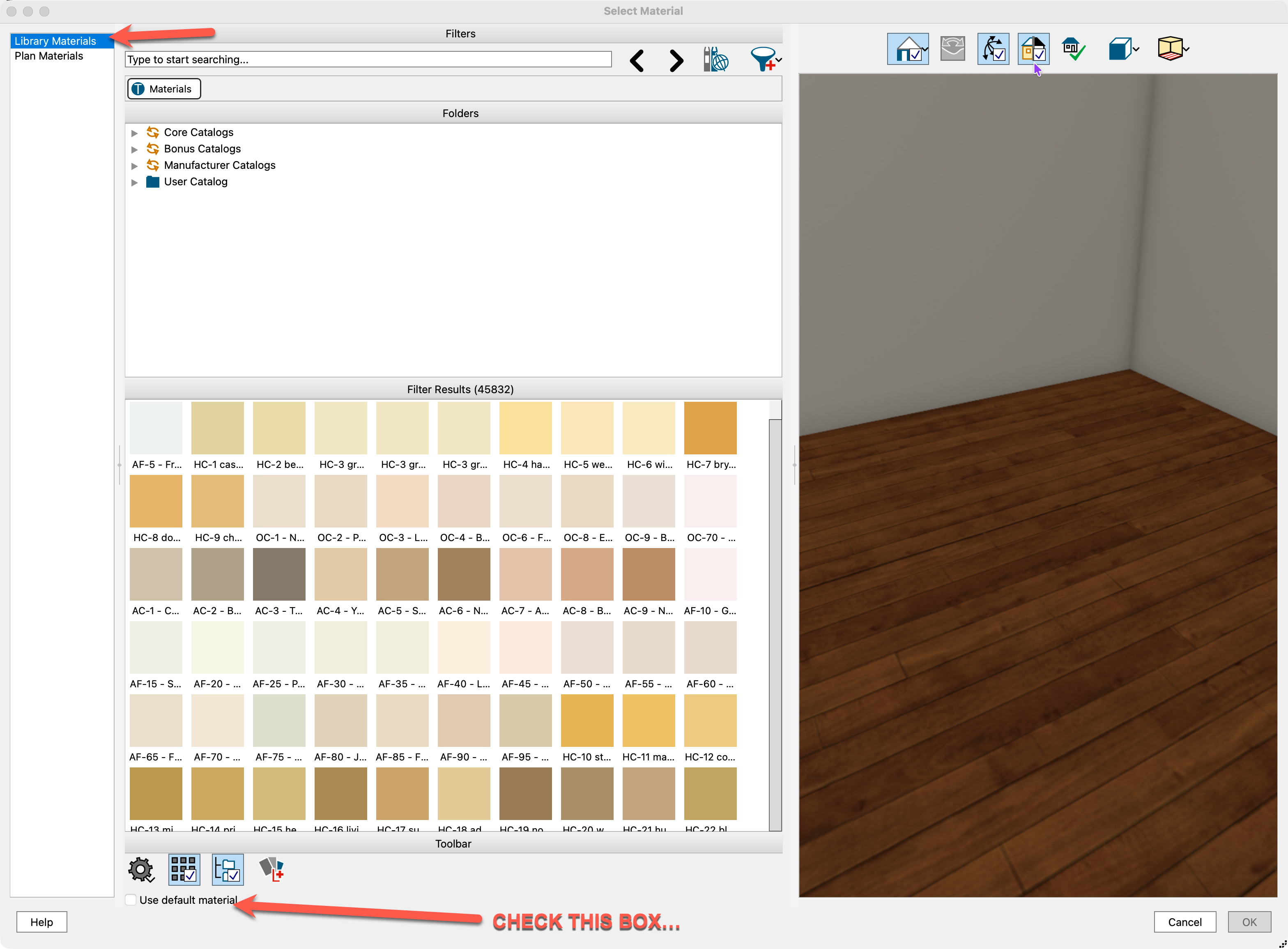

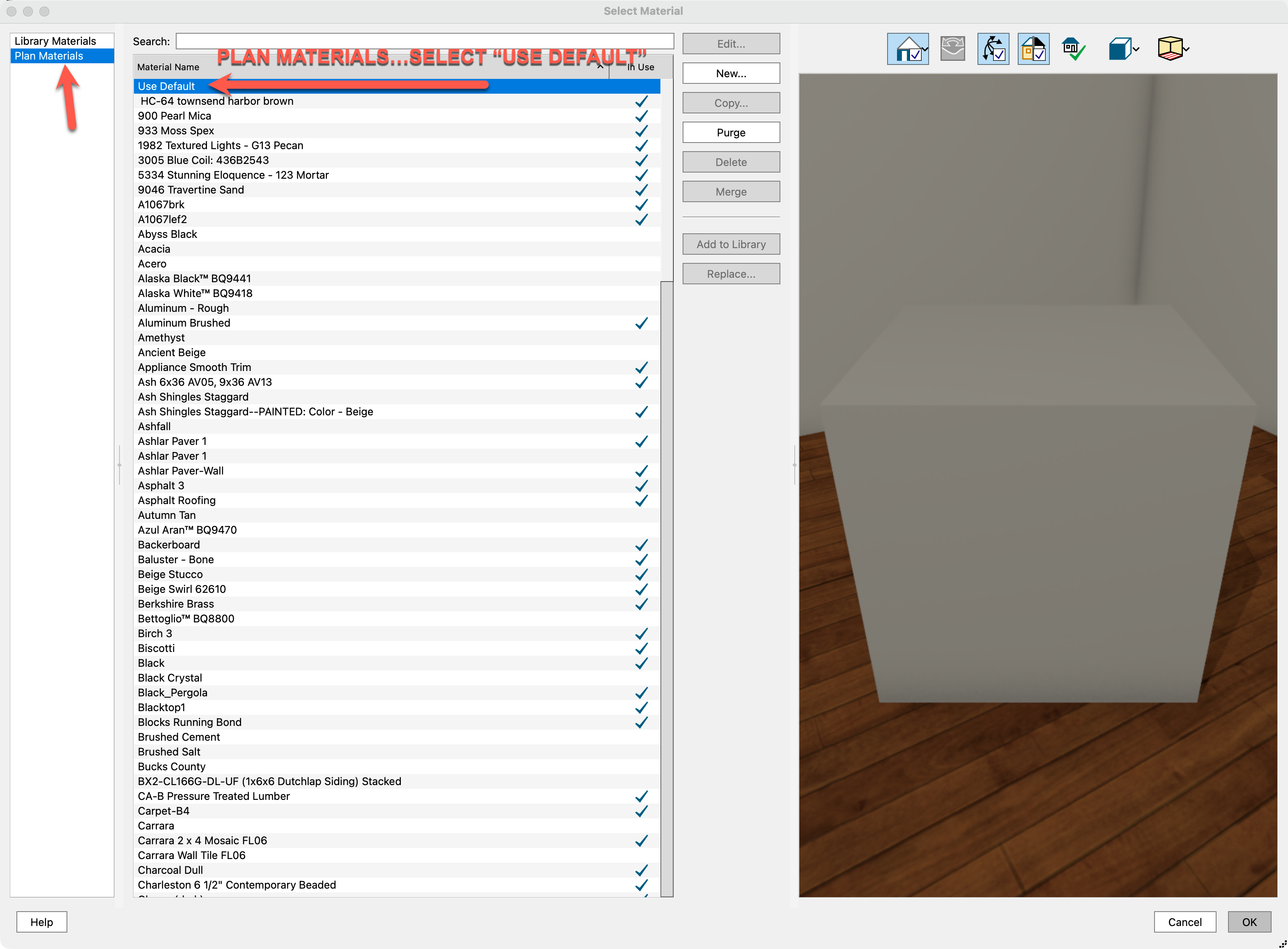

SNestor Posted February 13 Share Posted February 13 Define your wall with the materials you want, then...in the materials tab make sure all the materials listed show these as "default". If not, then open the material and change it to "Use Default" from the list of plan materials...or, check the box at the bottom of the LIBRARY MATERIALS dialogue..."Use Default Material" See attached; Link to comment Share on other sites More sharing options...
SC_drafting Posted February 13 Author Share Posted February 13 Both of those options fix the appearance of the wall, but when I delete the wall and make another wall of the same type I have to do it again. Is there a way to make that setting permanent? Link to comment Share on other sites More sharing options...
SNestor Posted February 13 Share Posted February 13 You should not have to be doing that...typically a wall will use its default material. You are probably copying a wall type where the wall material is not using the wall type definition material. Create a new wall type...define it with the materials you want and save it. The out of the box Chief template file contains numerous wall types that are defined correctly that you can copy and recreate...without changing the material properties. Link to comment Share on other sites More sharing options...
