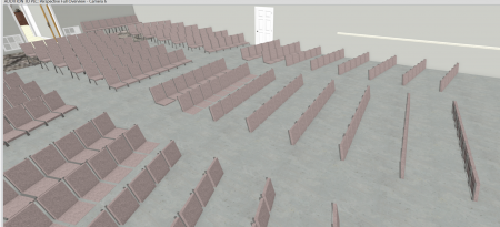

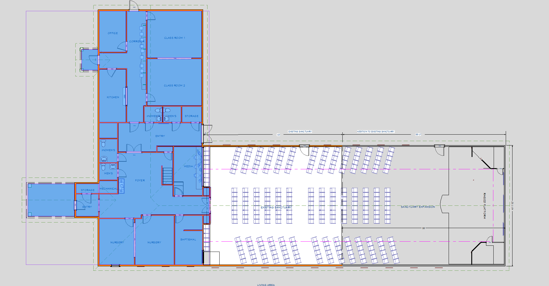

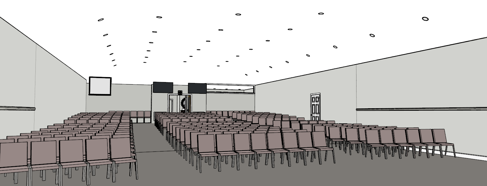

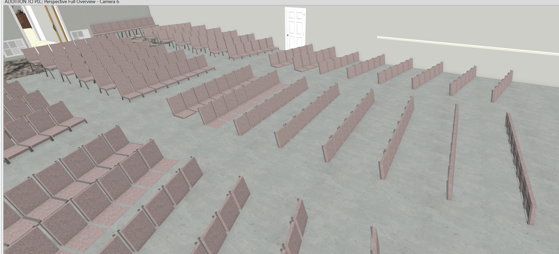

Evolution Posted February 12 Share Posted February 12 I am still working on the CD's for the Church sanctuary expansion. The problems keep multiplying every time I close and open the plan some strange anomaly jumps up (literally). The structure dimensions have continually changed and I do not have any idea how / why and now in order to get the floor heights to be the same in every room (although) I set them in the defaults, I have to go into each room and now set the floor to zero. I just don't know what to do to keep my drawing from changing constantly. Now the sanctuary floor has eaten my furniture. ADDITION TO PLC.zip Link to comment Share on other sites More sharing options...

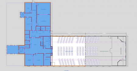

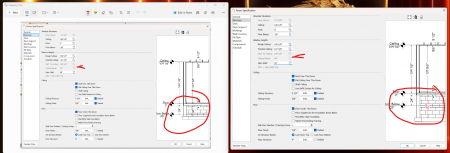

robdyck Posted February 12 Share Posted February 12 You need to divide the foundation into rooms that align with the different floor levels on the main floor. Without this separation, it will continually change. Alternatively, you can delete the foundation entirely...if you have no specific need for it. The Media Room is marked as Floor supplied...by below. Make this floor structure the same as all other rooms at floor elevation 0". The easiest way to divide the foundation into rooms is to select the dividing walls from the main floor and the copy-paste-in-place to the foundation level. The go back to the main floor and check all floor elevations and floor structure conditions. I have the blue highlighted rooms at 0". After doing the tasks I mentioned, the result works out as expected. Link to comment Share on other sites More sharing options...
