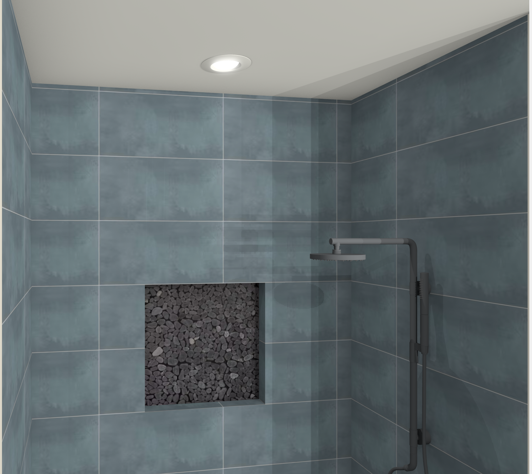

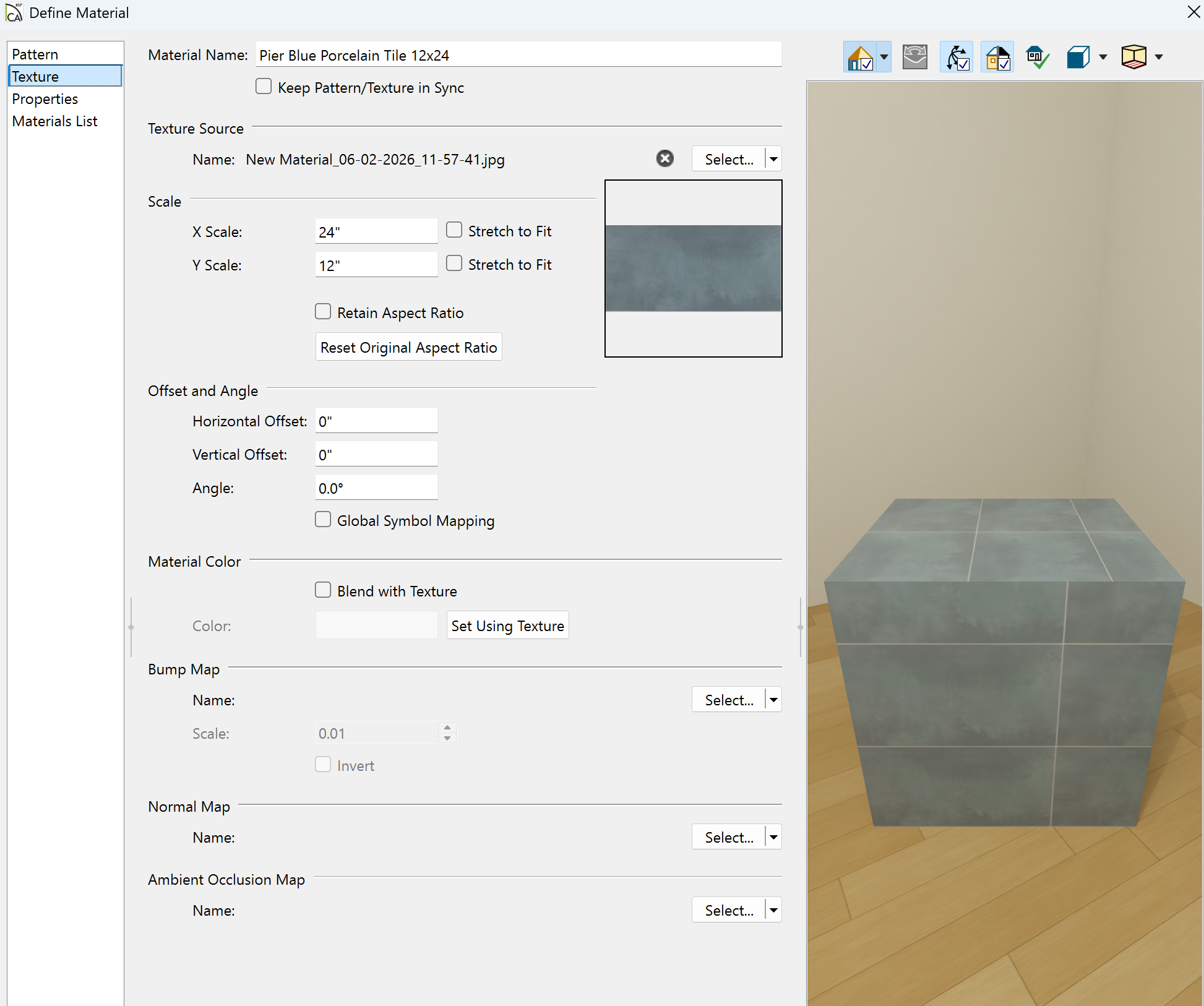

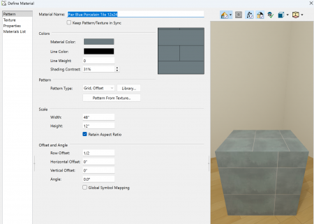

Elliot Posted February 6 Share Posted February 6 I have always struggled with creating 3d images of the actual tiles which my client chooses. I tried working in material builder, and although it is very powerful, I really like doing screen captures and using the actual tiles which they select. But I just cannot make Chief do an offset tile no matter how many settings I try or how many times I watch the help videos. I have done a screen shot of the settings pages and the image. On the define materials page it shows the offset for the pattern because I select "grid,offset" but it doesn't show in the 3d image to the right and doesn't work in my shower image. Can someone tell me what I am doing wrong? thanks Link to comment Share on other sites More sharing options...
Chrisb222 Posted February 6 Share Posted February 6 15 minutes ago, Elliot said: Can someone tell me what I am doing wrong? thanks The 3D image is using what you see in the Texture panel's Texture Source area: the image file isn't a grid arrangement, it's one single rectangle. You'll need an image of the tile in a grid arrangement for the 3D to look right. There are no settings in the Texture panel to create a grid pattern, since it simply uses a static picture file which it can't modify. Link to comment Share on other sites More sharing options...
Chrisb222 Posted February 6 Share Posted February 6 17 minutes ago, Elliot said: On the define materials page it shows the offset for the pattern because I select "grid,offset" To elaborate, settings in the Pattern panel only affect vector views and hand-drawn lines. So placing a "grid, offset" instruction there has no effect on the raster (realistic) views. Link to comment Share on other sites More sharing options...

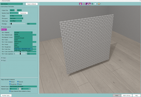

MollyNDG Posted February 10 Share Posted February 10 You can import the image directly into the material builder, under the tile material drop down there is an option for importing an image. Then below, image input -> browse. You can also make it seamless next to Source Image Edge Edit. Link to comment Share on other sites More sharing options...
