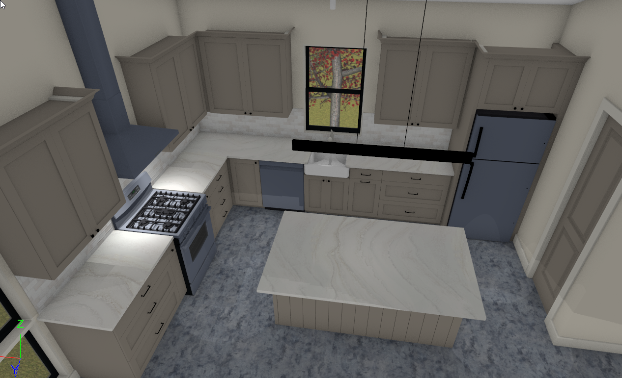

Here is a view using standard camera, daylight set to day.  All the lights I named above are turned on.

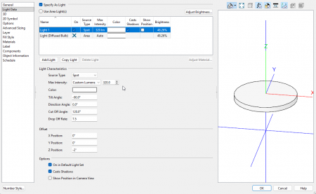

Here is the spec panel one of the four puck lights I placed manually under the hood.  The lighting has two components, a lumen strength setting for the bulb, and something called area lighting, apparently because of the material (lighting white) used for the lens.
Note that in the camera view, something is lighting the range.  It's not the pucks, because they are turned off.  It is the lighting white material.
But lighting white material is used in the pendant over the island, and in all the ceiling spots.  Why aren't they emitting light in this standard camera view?
Here is a PBR render, taken with daylight off.  I want to dial back the undercab lighting, dial up the lighting from the ceiling spots, and dial down the hood lighting the range, but this area lighting is something I don't understand and seems to be messing with the scene.
