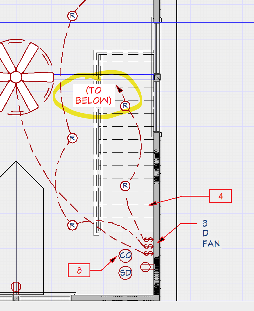

Fotis1960 Posted February 1 Share Posted February 1 How do you all show electrical connections when they connect switches and/or lights on multiple floors? Thanks Link to comment Share on other sites More sharing options...
JKEdmo Posted February 1 Share Posted February 1 This is what I do for switches. For example 3-way switch for stairwell light(s). I'll show a leader line from fixture with arrow and note either "to above" or "to below." Should be clear enough for the electrician. 2 Link to comment Share on other sites More sharing options...

DBCooper Posted February 1 Share Posted February 1 Another thing is that when you need there to be a 3/4-way switch, you will have to manually place the 3/4-way switch because the automatic stuff won't work when they are not actually connected. Just place the switch directly from the library and it should stick to be what you need. Link to comment Share on other sites More sharing options...
