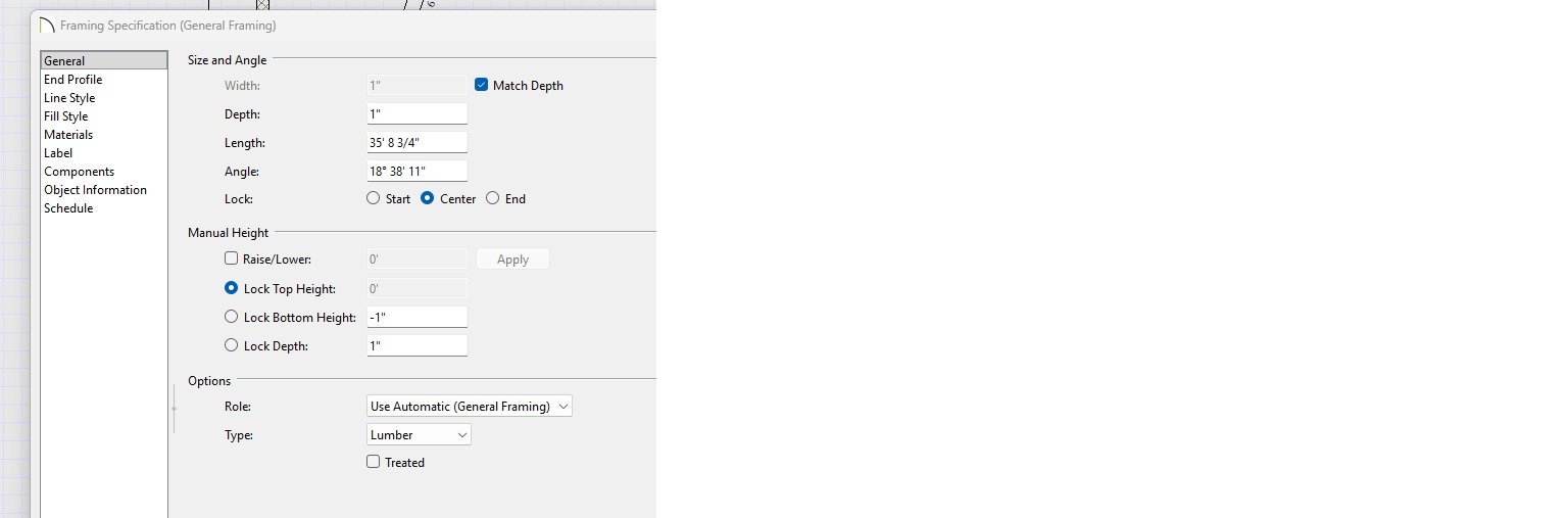

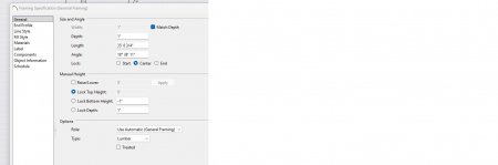

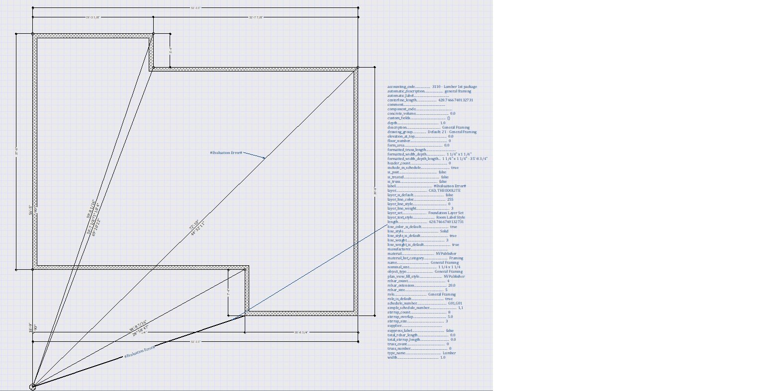

Brady33 Posted February 1 Share Posted February 1 Project export and screen shots Good day, I'm a builder and draft my own work. I'm trying to streamline getting the data for my site work of laying out foundations. I use a theodolite with DMS and a tape to lay out the footings and then pin the block corners for my masons. Assembling the data to do this is cumbersome. On the foundation layer I use a CAD line to draw from XY 0,0 to all the corners of the foundation block. A CAD line easily presents the distance and angle but doesn't seem to have information that can extrapolated to a schedule. The first question is: Can that be done? Can I build a schedule to get CAD Line's information? I've tried using a general framing member and can get the formatted distance into the schedule but I can't figure out the macro to get angle into the schedule. There is clearly Angle information for general framing members (as seen in the screen shot), but if I run a Object Properties macro on the framing member, there is no "angle" macro. Object Properties on a CAD line results in evaluation error. I've included the pictures and .caproj in the link as it's too large to upload directly. Thanks for your time and consideration. Link to comment Share on other sites More sharing options...

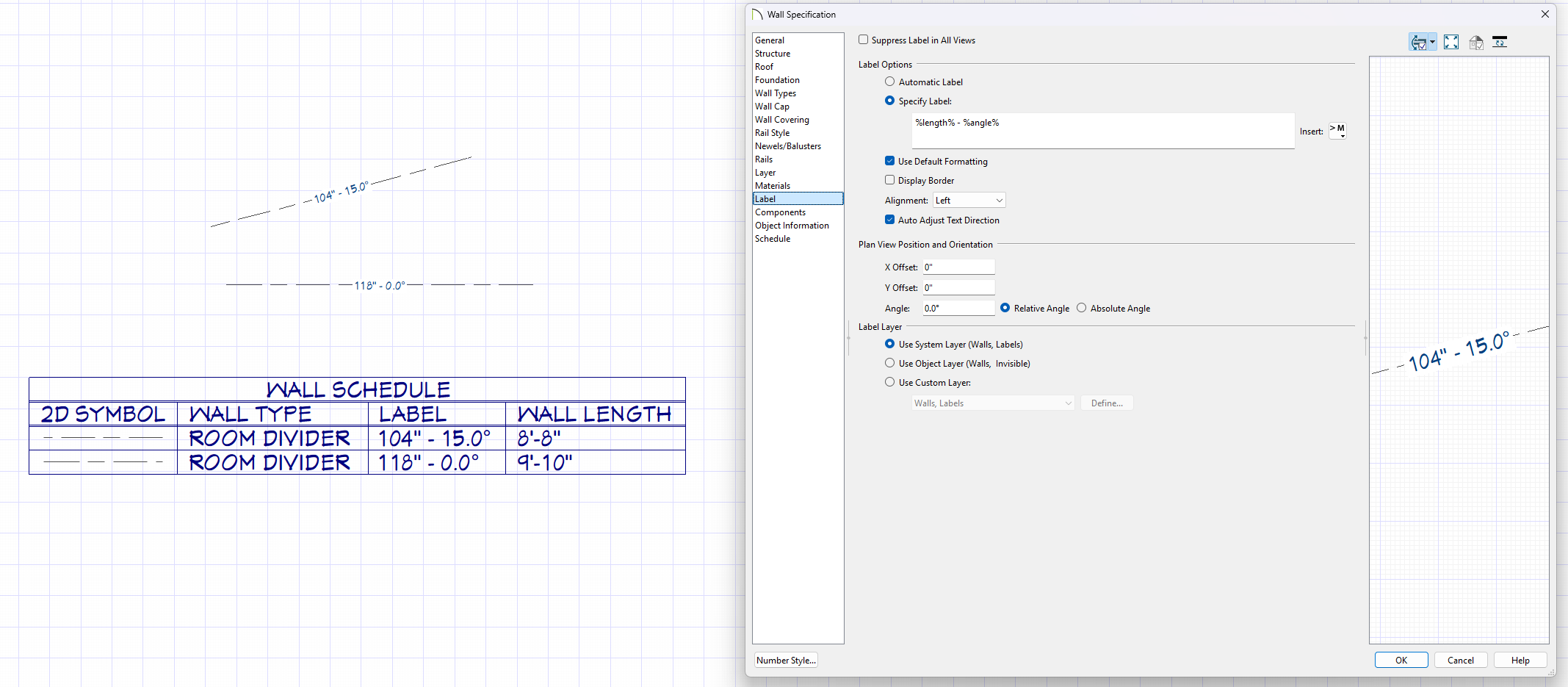

DBCooper Posted February 1 Share Posted February 1 You might be able to get what you want easier using a "room divider" instead of a cad line or framing member. I just made some room dividers and marked them as "no room def" and then put the length and angle in the label. Link to comment Share on other sites More sharing options...

Brady33 Posted February 2 Author Share Posted February 2 Update. I still can't get the Angle information into a schedule unless it's on a 2D Symbol. Then the line is so small you can't see the angle on it. You can't use a Room Divider as it's snap and connects to a wall. The line needs to snap to a foundation/block corner to give correct length and DMS. Link to comment Share on other sites More sharing options...

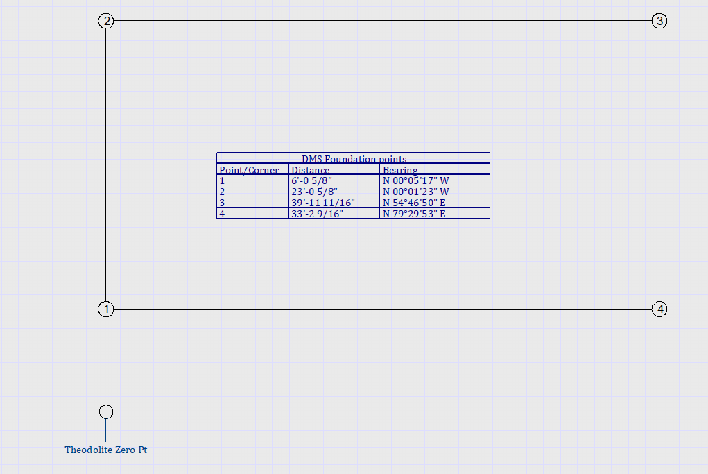

Renerabbitt Posted February 2 Share Posted February 2 1 hour ago, Brady33 said: I still can't get the Angle information into a schedule unless it's on a 2D Symbol. You can use notes, they publish their xy position, then interpolate length and angle with macros 1 Link to comment Share on other sites More sharing options...
Solution Brady33 Posted February 5 Author Solution Share Posted February 5 I have no idea if this is helpful to anyone. But as a builder that lays out his own projects, it's a huge time saver. It can be done with as few as 3 macros. This is a CAD layer view with a simple polyline rectangle. Real application I would send a house plan footprint or CAD detail from view to CAD, cut and paste it into a saved "DMS Detail" then start dropping my Notes on points. You have to set up your Notes and add some custom fields to attach the macros, but it's pretty cut and dry. There's an Azimuth or Bearing macro, which are redundant if you don't care about NSEW. There's an X and Y macro (not displayed) if you need to know your grid locations pertinent to Chief. Holler if you need help setting up Notes. DMS.json Link to comment Share on other sites More sharing options...
Renerabbitt Posted February 5 Share Posted February 5 5 hours ago, Brady33 said: There's an Azimuth or Bearing macro, which are redundant if you don't care about NSEW. There's an X and Y macro (not displayed) if you need to know your grid locations pertinent to Chief. Holler if you need help setting up Notes. Nice you got it figured out. You can cad block your polyline and notes and even turn this utility into a conditional switch btw...kind of a fun utility for some. I'll have to find it but I did put into YouTube or this forum a script for calculating curvature of earth and polar conversions for correcting from sheet space to world coordinates. Might be able to find it or punch that into an ai script utility. It would only really matter for larger lots Link to comment Share on other sites More sharing options...
