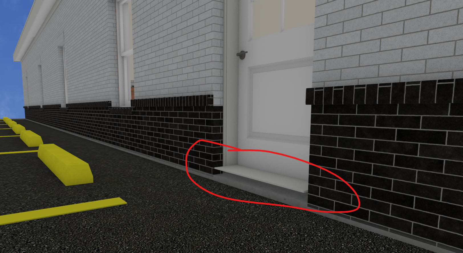

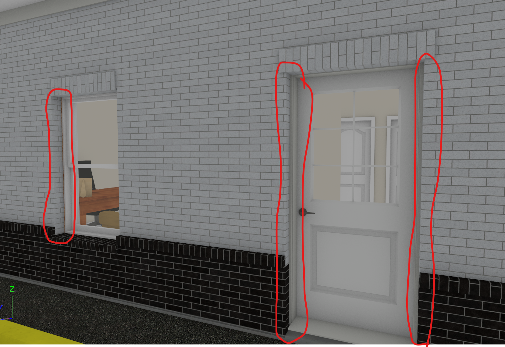

winterdd Posted January 29 Share Posted January 29 Anyone ever seen this on X17? I have been removing the exterior casing on windows, when the wall is brick veneer, for years for a true look. Now there are gaps around the windows? Also, why is the brick covering my door brick moldings? Just curious......It's like these past new homes I am doing in X17 throw curveballs on something lately and I haven't even messed with any settings. Thanks. Link to comment Share on other sites More sharing options...
winterdd Posted January 29 Author Share Posted January 29 And then you got the fdn building a brick ledge under the door leaving a gap?? Link to comment Share on other sites More sharing options...

robdyck Posted January 30 Share Posted January 30 The gap is the rough opening...because your brick layer is checked as 'framing'. Open the wall definition and make sure that only the framing layers is checked as framing. 2 Link to comment Share on other sites More sharing options...
winterdd Posted January 30 Author Share Posted January 30 1 minute ago, robdyck said: The gap is the rough opening...because your brick layer is checked as 'framing'. Open the wall definition and make sure that only the framing layers is checked as framing. How on earth did that happen? I promise I wasn't drinking whiskey when I started the plan file. haha 2 Link to comment Share on other sites More sharing options...
