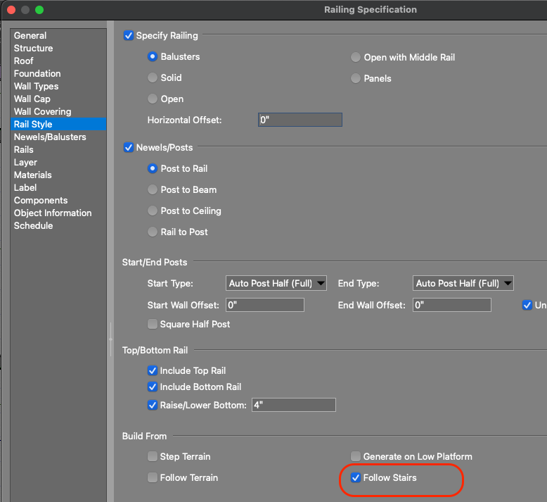

Draw a railing manually, place in position and check "Follow Stairs." Adjust as needed:
1442448497_Screenshot2026-01-23at2_43_43PM.thumb.png.5fe66906bf192aa838325f54f3e427b6.png
Thank you.  Worked great!
