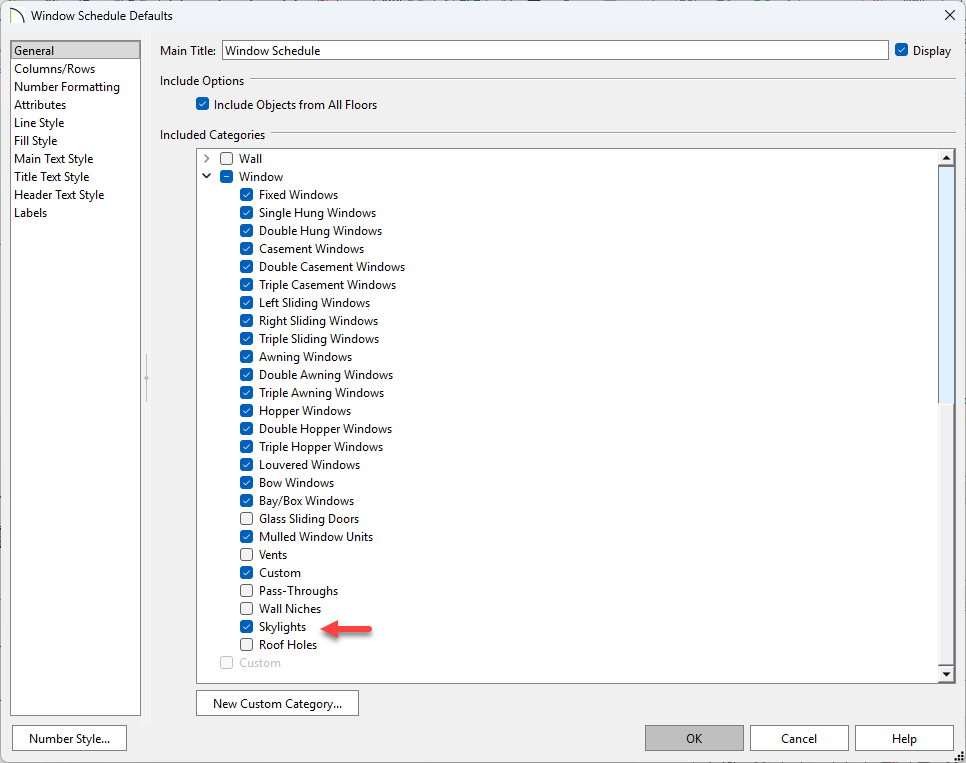

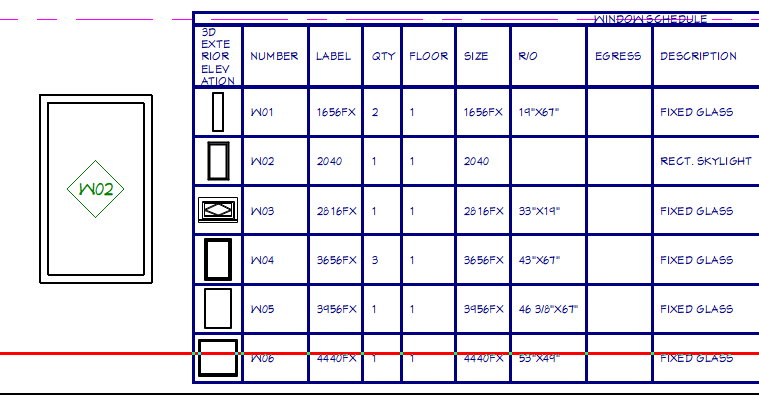

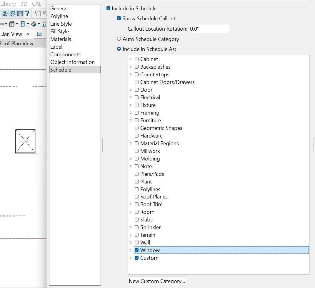

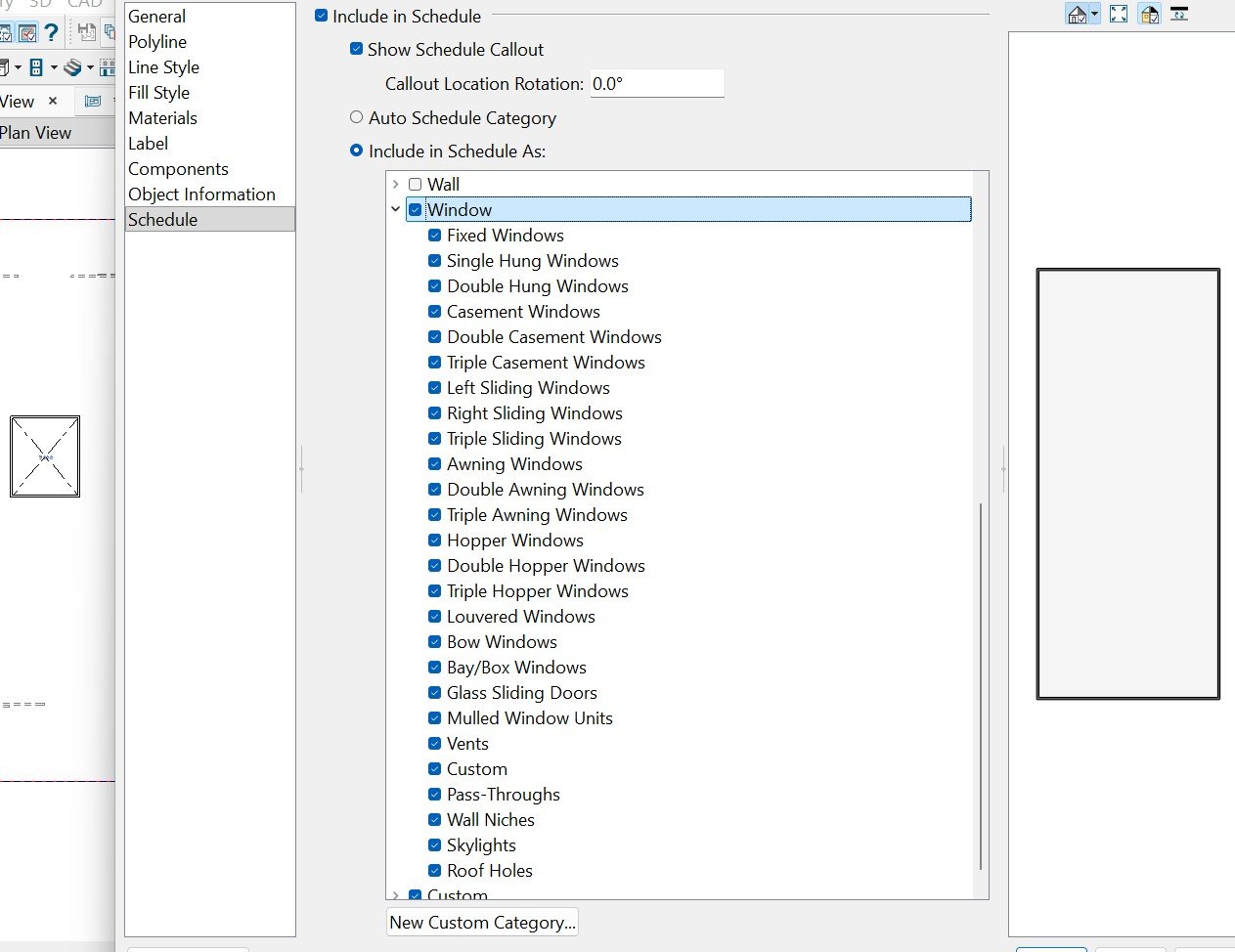

Doug_N Posted January 14 Share Posted January 14 (edited) Normally, the skylights are not included in the window schedule This is a DBX from preferences where the skylight box has been selected for inclusion in the window schedule Here a skylight has been inserted into a roof, and showes up in the window schedule. Edited January 14 by Doug_N 2 Link to comment Share on other sites More sharing options...
