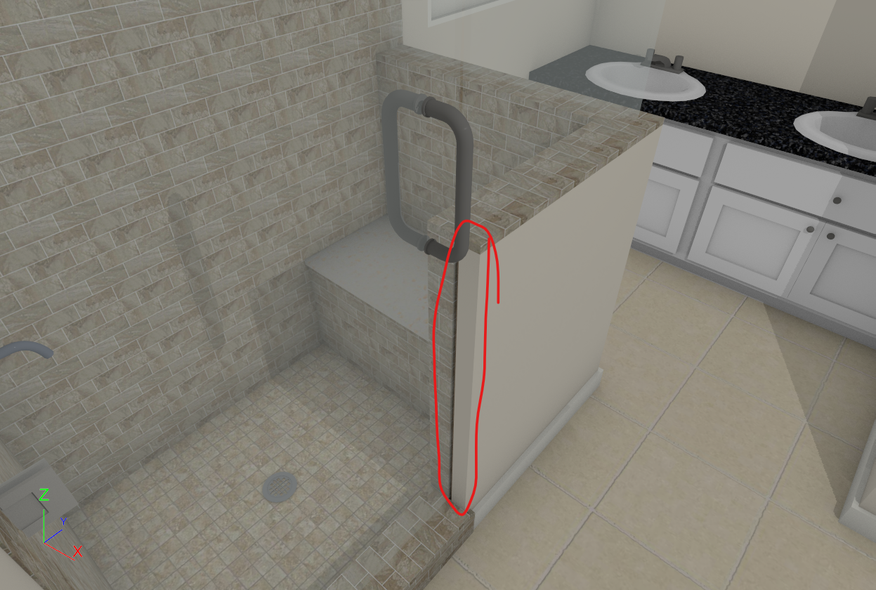

builtright3 Posted January 7 Share Posted January 7 Hey Guys, Is there a simple way to get the tile on the end of this wall? Any help would be appreciated. Link to comment Share on other sites More sharing options...
RobDesLLC Posted January 7 Share Posted January 7 I've made a molding 1/4" thick by whatever the height is, made the material my wall tile, and ran it along the inside faces and end of the pony walls. Link to comment Share on other sites More sharing options...
javatom Posted January 7 Share Posted January 7 A material region will also work. Link to comment Share on other sites More sharing options...
builtright3 Posted January 7 Author Share Posted January 7 5 minutes ago, javatom said: A material region will also work. I tried the material region but I couldnt get it to work at the end of the wall. Could I be doing something wrong? Link to comment Share on other sites More sharing options...
javatom Posted January 7 Share Posted January 7 It might have to be a P-solid. Material regions can sometimes get clipped by objects. Link to comment Share on other sites More sharing options...
builtright3 Posted January 8 Author Share Posted January 8 Thanks guy's that was a big help. Problem solved Link to comment Share on other sites More sharing options...
