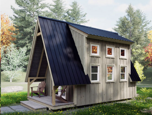

EquityDesigns Posted January 4 Share Posted January 4 How can you remove the main pitch roof in front of a shed dormer? Link to comment Share on other sites More sharing options...
JiAngelo Posted January 4 Share Posted January 4 Build the shed dormer with the appropriate ceiling height and roof pitch that meets at or below the existing peak. Link to comment Share on other sites More sharing options...
PitMan71 Posted January 4 Share Posted January 4 4 hours ago, EquityDesigns said: How can you remove the main pitch roof in front of a shed dormer? Try stretching the roof hole out to the edge. The only issue is there will be separate walls (Dormer wall on top of the first floor wall) and I don't think that is your ultimate intention. Anyway, hope you get it. This is a cool looking small house. Link to comment Share on other sites More sharing options...
joey_martin Posted January 4 Share Posted January 4 I generally just add 2 cuts, 1 at each side of the dormer, at the fascia line and pull the main roof back to the ridge line. It will separate into 2 roof planes at that point. Link to comment Share on other sites More sharing options...
