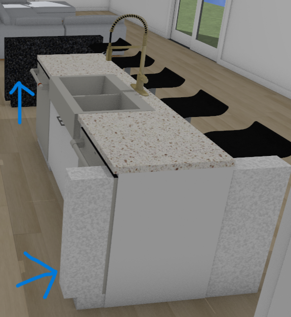

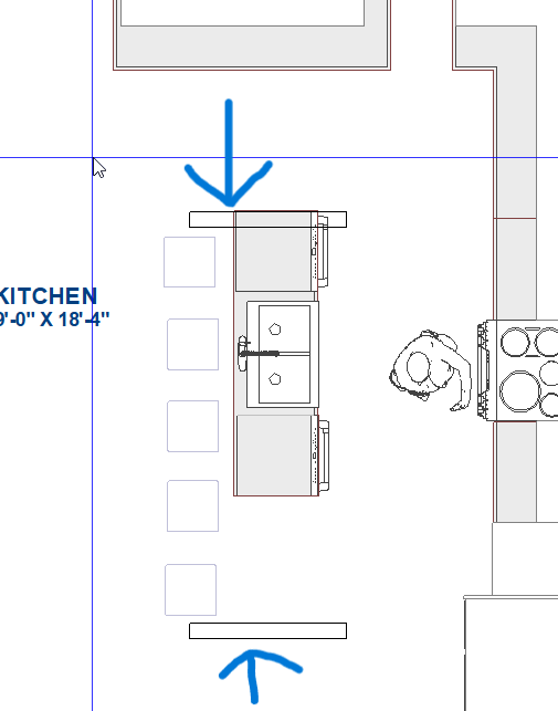

carolynginder Posted 4 hours ago Share Posted 4 hours ago (edited) I had someone make my 3d model in Chief Architect and then I put it back into Home Designer Architectural and there are these countertop parts I cannot select. Can someone tell me why I cannot select these items? Edited 4 hours ago by carolynginder Link to comment Share on other sites More sharing options...

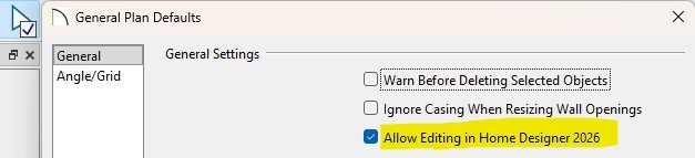

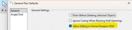

scottharris Posted 59 minutes ago Share Posted 59 minutes ago Sometimes Chief Architect plans need to be marked as ‘editable in Home Designer’. Otherwise you cannot edit the plan. If you can select other items and edit, could be the countertops may not be editable from Chief Architect to Home Designer. Link to comment Share on other sites More sharing options...
Garybills Posted just now Share Posted just now If you can edit other things, I would guess they have used 3d solid to create those. I have done a lot of plans in Chief for people to edit in Home Designer; I always tell them anything that they won't be able to edit. Link to comment Share on other sites More sharing options...
