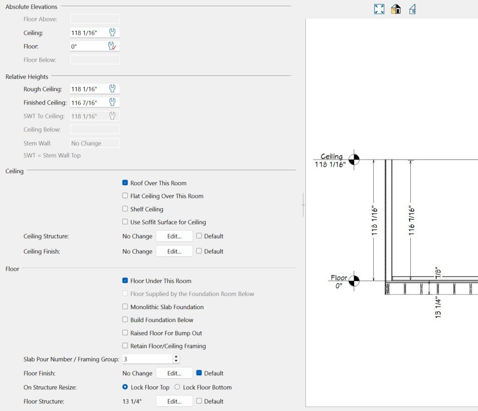

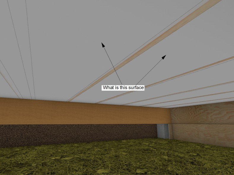

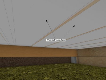

MN_JohnH Posted December 15, 2025 Share Posted December 15, 2025 I have a crawlspace under this addition and there is a surface there at the level of the bottom of the floor joist with no thickness and I can't click on it to figure out what it is. I can't get the file down to under 14mb even zipped so I have a link to a dropbox file https://www.dropbox.com/scl/fi/moyz5trozohubrrg0cycp/Problem.plan?rlkey=4fn1ul395kdfz0t0i5rtgaq63&st=i7jc3hjt&dl=0 That is not a room so there is not ceiling there I don't think. Camera #14 shows the space where the problem exists. Link to comment Share on other sites More sharing options...

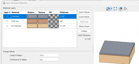

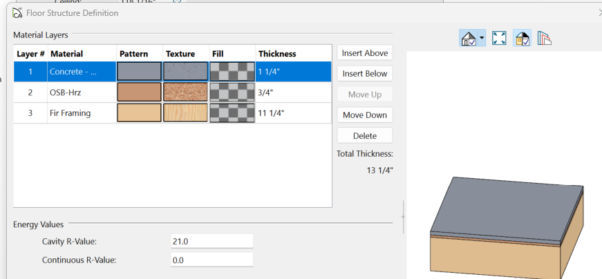

jmsisco Posted December 15, 2025 Share Posted December 15, 2025 (edited) Edit the floor structure to what you require. It is currently concret and Framing Edited December 15, 2025 by jmsisco Link to comment Share on other sites More sharing options...
MN_JohnH Posted December 15, 2025 Author Share Posted December 15, 2025 17 minutes ago, jmsisco said: Edit the floor structure to what you require. It is currently concret and Framing Thanks, The concrete is a 1.5" overpour for the floor heat, it is on top of the OSB sheathing. I don't think that would cause my problem but obviously I am missing something. Link to comment Share on other sites More sharing options...
ChiefTylerL Posted December 15, 2025 Share Posted December 15, 2025 Hello @MN_JohnH, You don't have any kind of foundation room definition so the software is seeing your entire building as cantilevered, so what you're seeing is the cantilever underside material. One solution would be to open your Room Specification, go to the Materials panel, select the cantilever underside material, and change it to No Material or Insulation Air Gap. I hope this helps! 1 1 Link to comment Share on other sites More sharing options...
MN_JohnH Posted December 16, 2025 Author Share Posted December 16, 2025 44 minutes ago, ChiefTylerL said: Hello @MN_JohnH, You don't have any kind of foundation room definition so the software is seeing your entire building as cantilevered, so what you're seeing is the cantilever underside material. One solution would be to open your Room Specification, go to the Materials panel, select the cantilever underside material, and change it to No Material or Insulation Air Gap. I hope this helps! Thanks, I could find a way to eliminate the material on the cantilever but I just drew in invisible foundation walls and that fixed it. I figure it was something like that but I didn't think to try it. Thanks for leading me in the right direction. Link to comment Share on other sites More sharing options...
