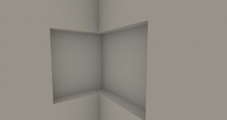

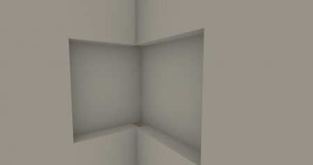

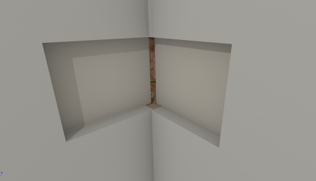

Gary-Doski Posted December 5, 2025 Share Posted December 5, 2025 I thought the corner niche would fill in similar to the corner window? Anybody else have better luck with this? Link to comment Share on other sites More sharing options...
Rookie65 Posted December 5, 2025 Share Posted December 5, 2025 I'm guessing that maybe since it's under the window family, maybe it's including the trimmer framing? Link to comment Share on other sites More sharing options...

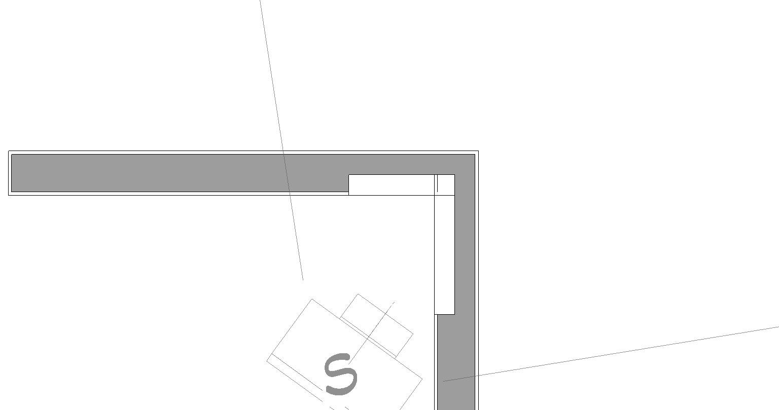

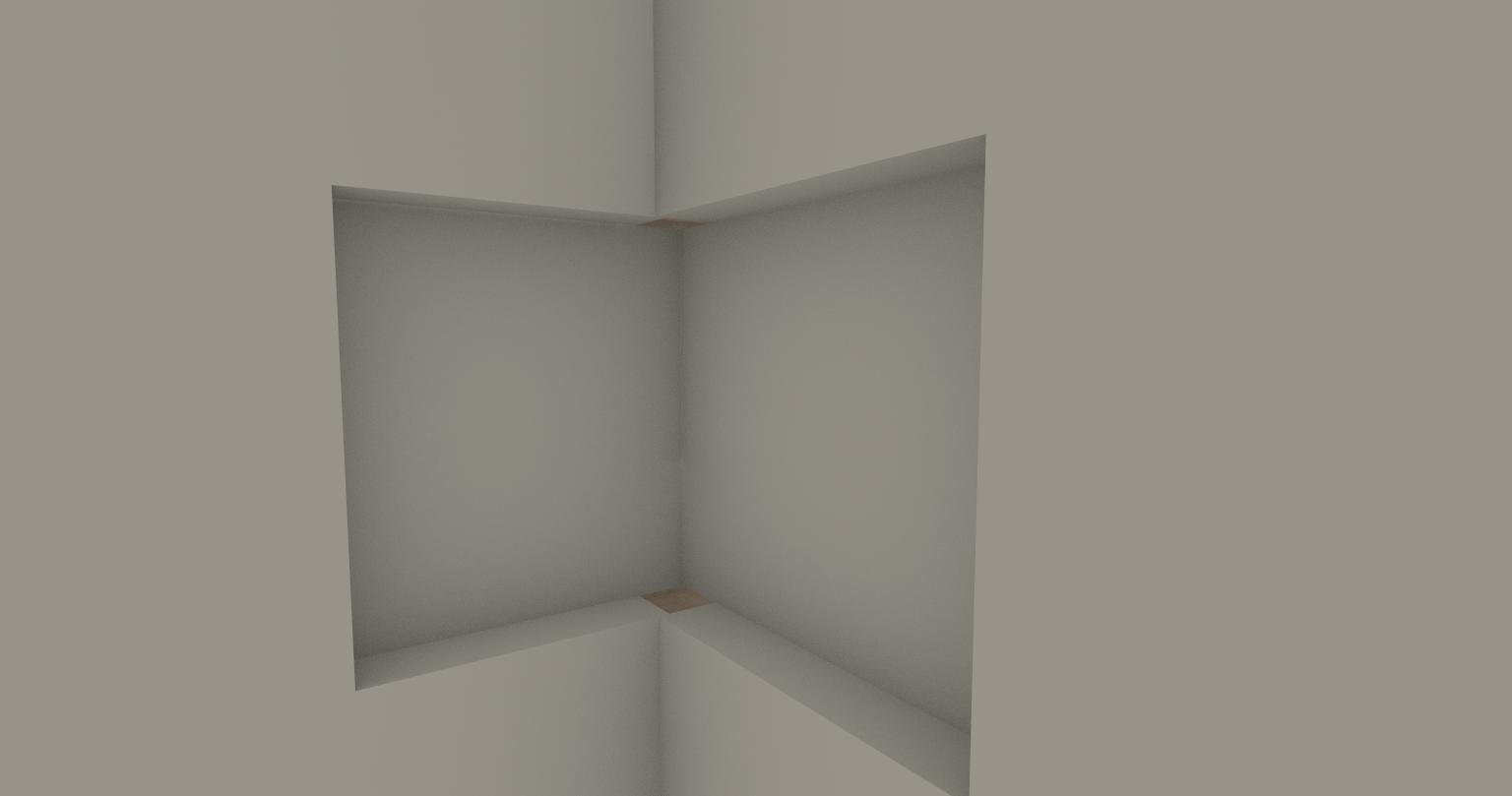

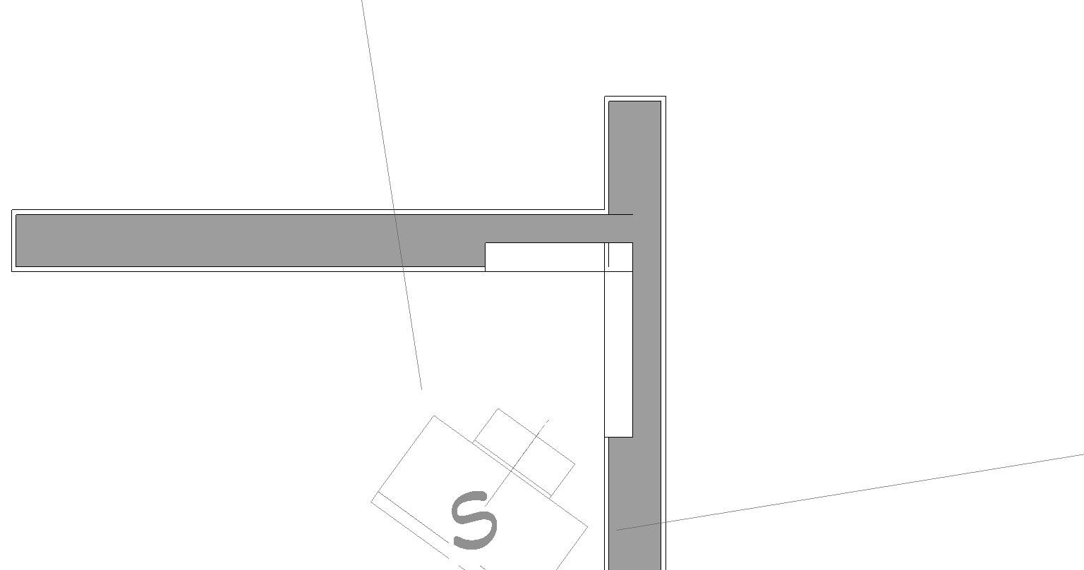

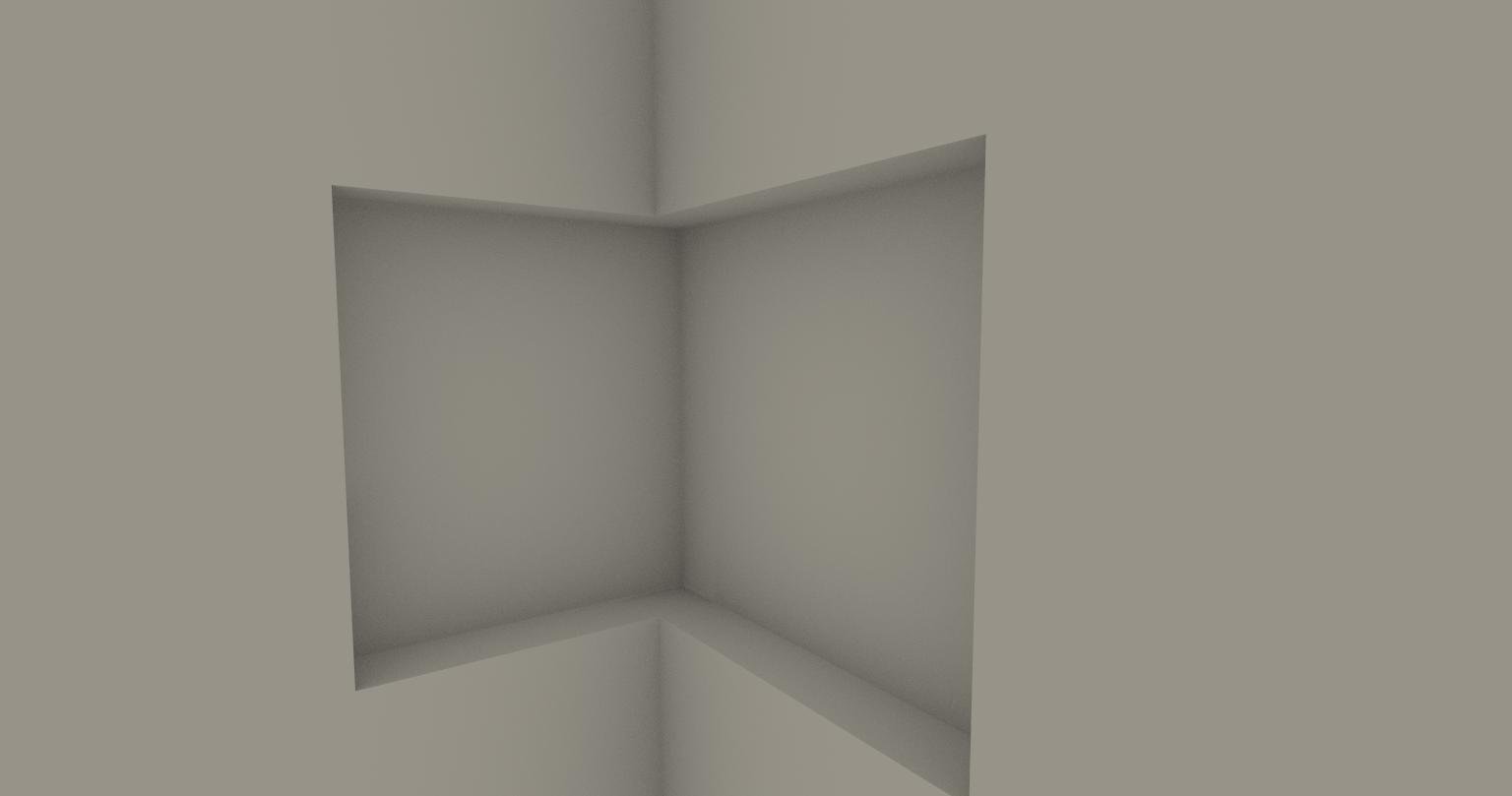

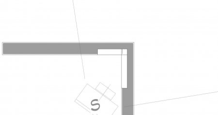

mtldesigns Posted December 5, 2025 Share Posted December 5, 2025 (edited) 1 hour ago, Gary-Doski said: similar to the corner window Hi Gary, I tried this on a 2x4 wall and got the same results. I'm thinking it has to do with wall framing, and that makes sense. When I change that wall to a 2x6, the niche filled in, except at the bottom corners (1 and 2 attached). However, when I continued either wall in the plan view, the whole box did fill in (3 and 4 attached) . Edited December 5, 2025 by mtldesigns Link to comment Share on other sites More sharing options...
