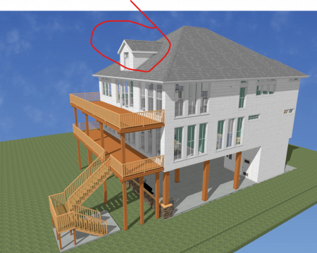

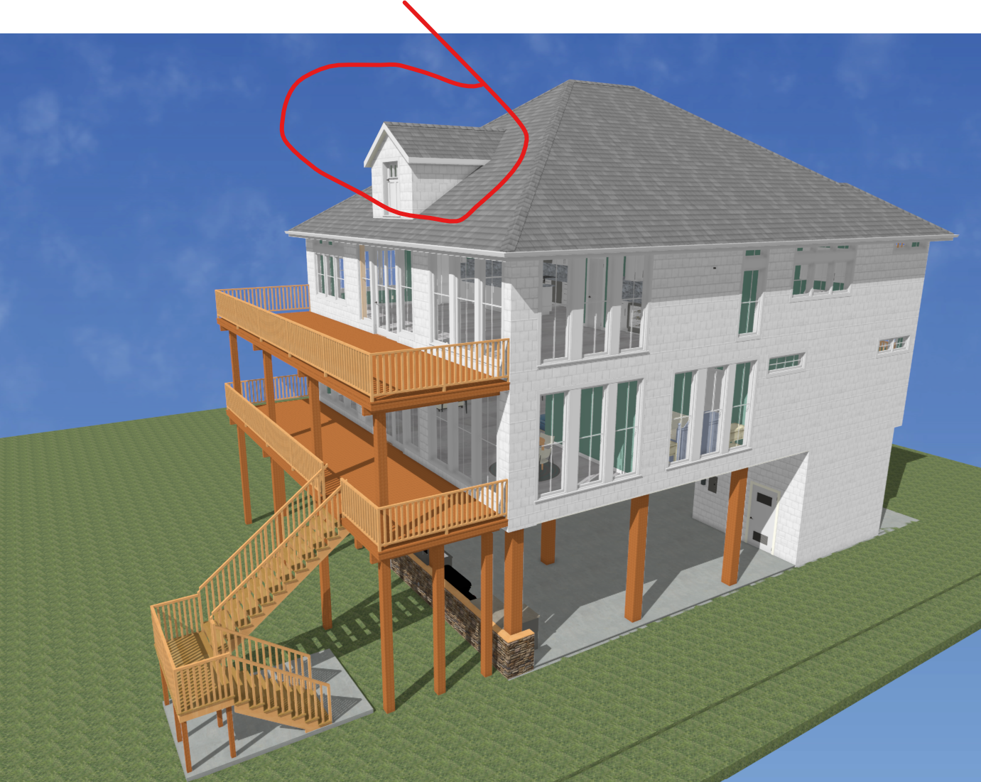

Evolution Posted December 3, 2025 Share Posted December 3, 2025 Still working on the Coastal res for the boss. He and wife want access onto what would be the floor of the attic and out through a dormer onto a small observation platform / deck. I dropped in a floating dormer, but I am not able to turn it into something like a roof top balcony with access via the dormer room. Since I added the dormer on the roof, it is (showing) on the attic level and I am not sure if I need to go down to the floor below which currently I do not have any walls placed. I built the attic using the tutorial for building a story and a half room. How would you model the "observation deck" and access? COASTAL RESIDENCE FOR CECIL and HELEN WILLIAMS OPTION WITH DORMER DECK FOR CHIEF FORUM.zip Link to comment Share on other sites More sharing options...
Doug_N Posted December 4, 2025 Share Posted December 4, 2025 The software would expect another floor to add a balcony. Add a floor and set the roof to ignore the top floor. Then you will be able to add a balcony, by creating a deck, then changing the room type to balcony. Link to comment Share on other sites More sharing options...
