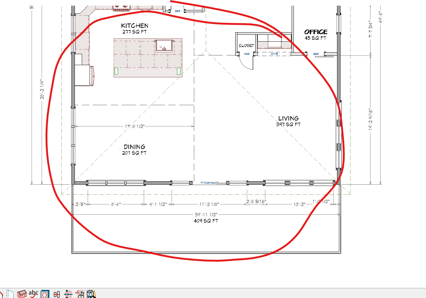

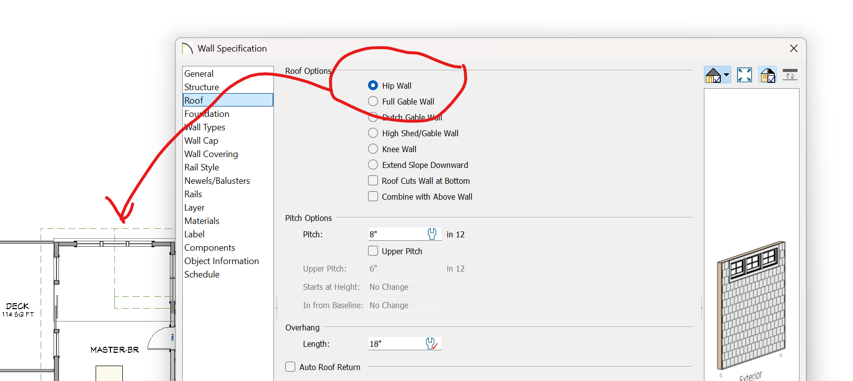

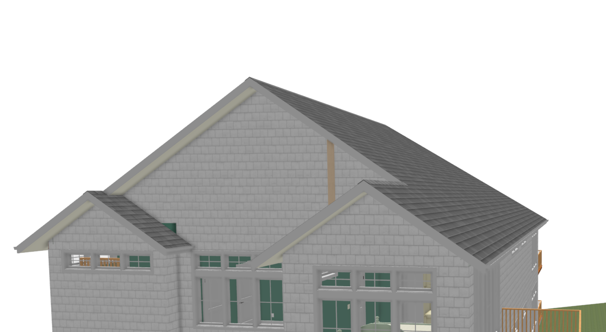

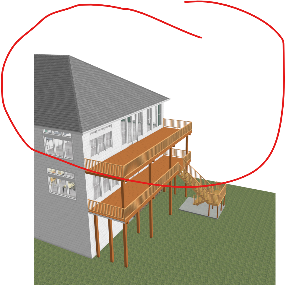

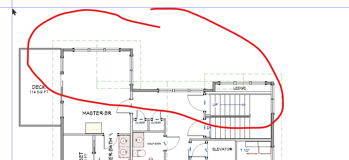

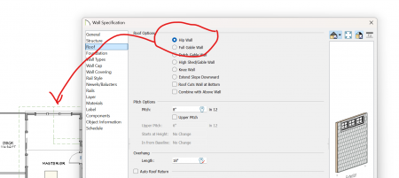

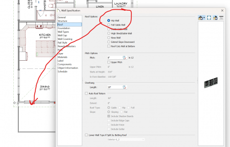

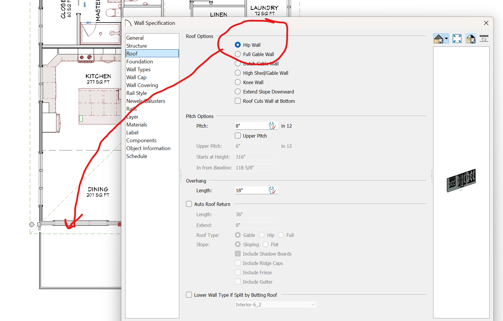

Evolution Posted December 3, 2025 Share Posted December 3, 2025 After changing my end walls (2) to gable and being directed to change them back to HIP style, one of the end walls changed back to HIP, but the other refuses to, even though under those walls' DBX I changed it to HIP. I know the software is MUCH smarter than I. Help please. COASTAL RESIDENCE FOR CECIL and HELEN WILLIAMS for CHIEF TALK FORUM.zip Link to comment Share on other sites More sharing options...
Solution Chrisb222 Posted December 3, 2025 Solution Share Posted December 3, 2025 18 minutes ago, Evolution said: Help please. You turned off auto roofs. Roof directives in the wall dialog don't work with manual roofs. Link to comment Share on other sites More sharing options...
