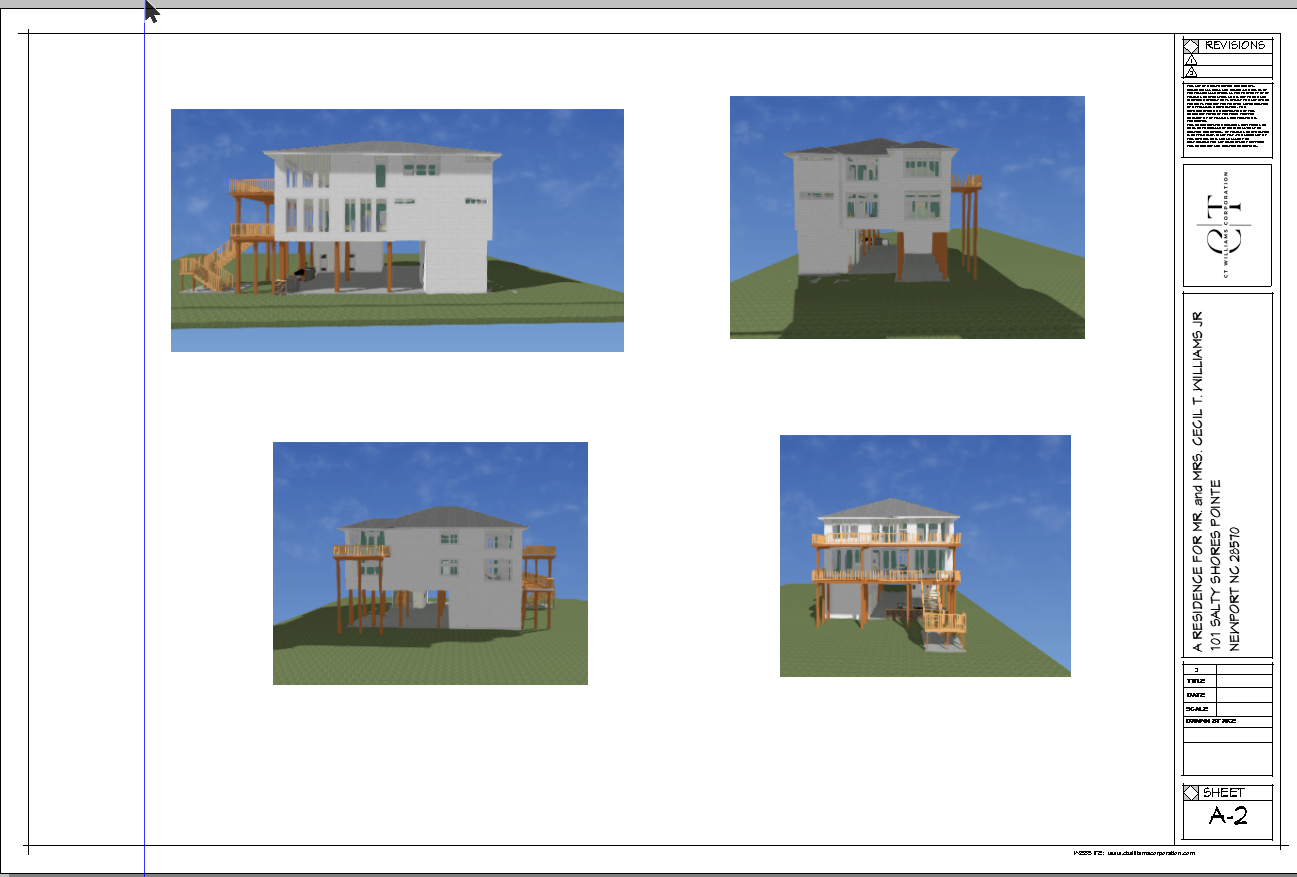

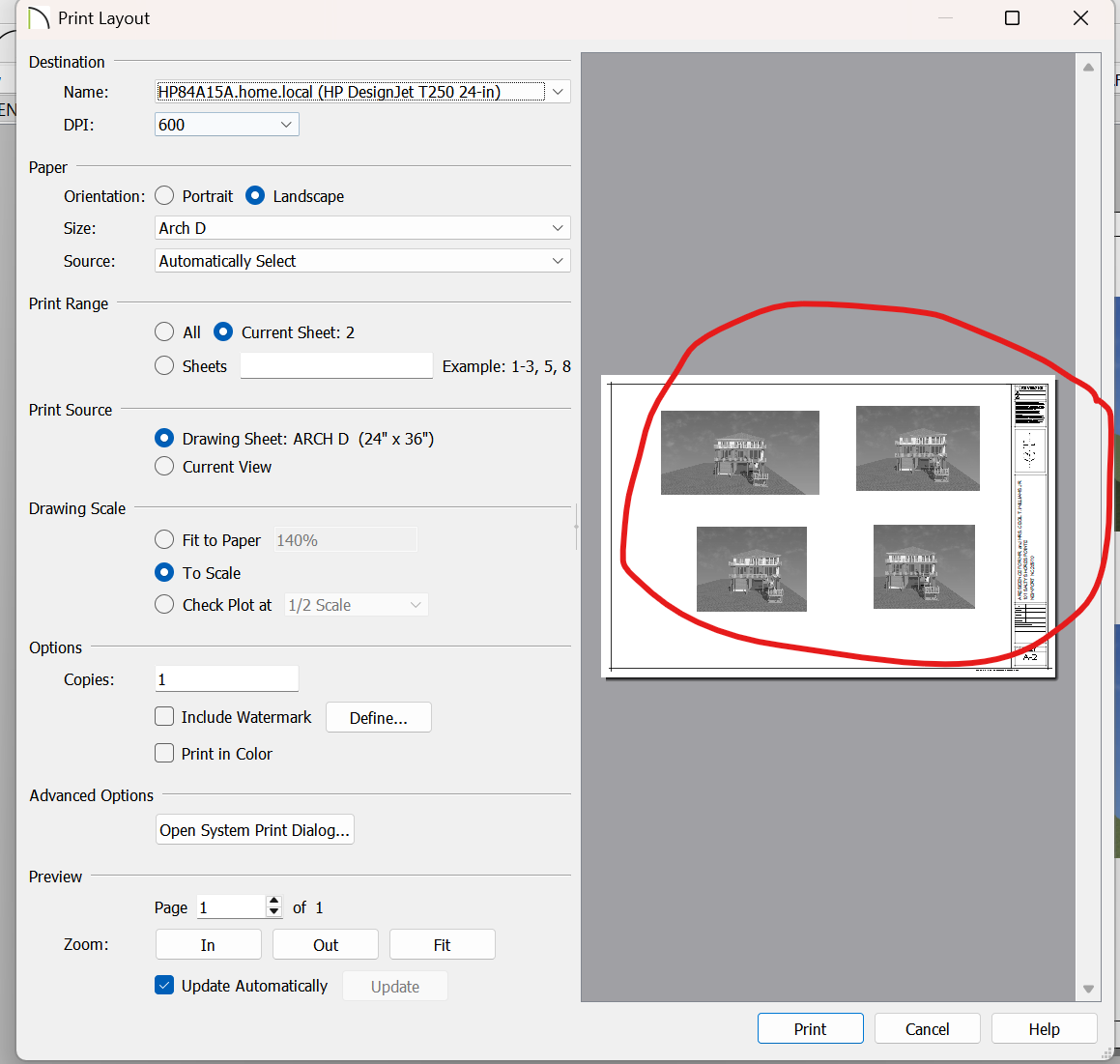

Evolution Posted November 25 Share Posted November 25 This should be simple, but I can't seem to find the trick to fix it. The snip on the left is my layout sheet I want to print for the client to look at. The snip on the right is what the print preview is producing which is all of one camera. How to I get it to print correctly? i don't see anything in the printer command Link to comment Share on other sites More sharing options...
Solution DBCooper Posted November 25 Solution Share Posted November 25 Did you send the same camera to the layout 4 times? Or did you create 4 different cameras and send them each to the layout? 1 Link to comment Share on other sites More sharing options...
Evolution Posted November 25 Author Share Posted November 25 DBC-apparently that was it. Thanks 1 Link to comment Share on other sites More sharing options...
