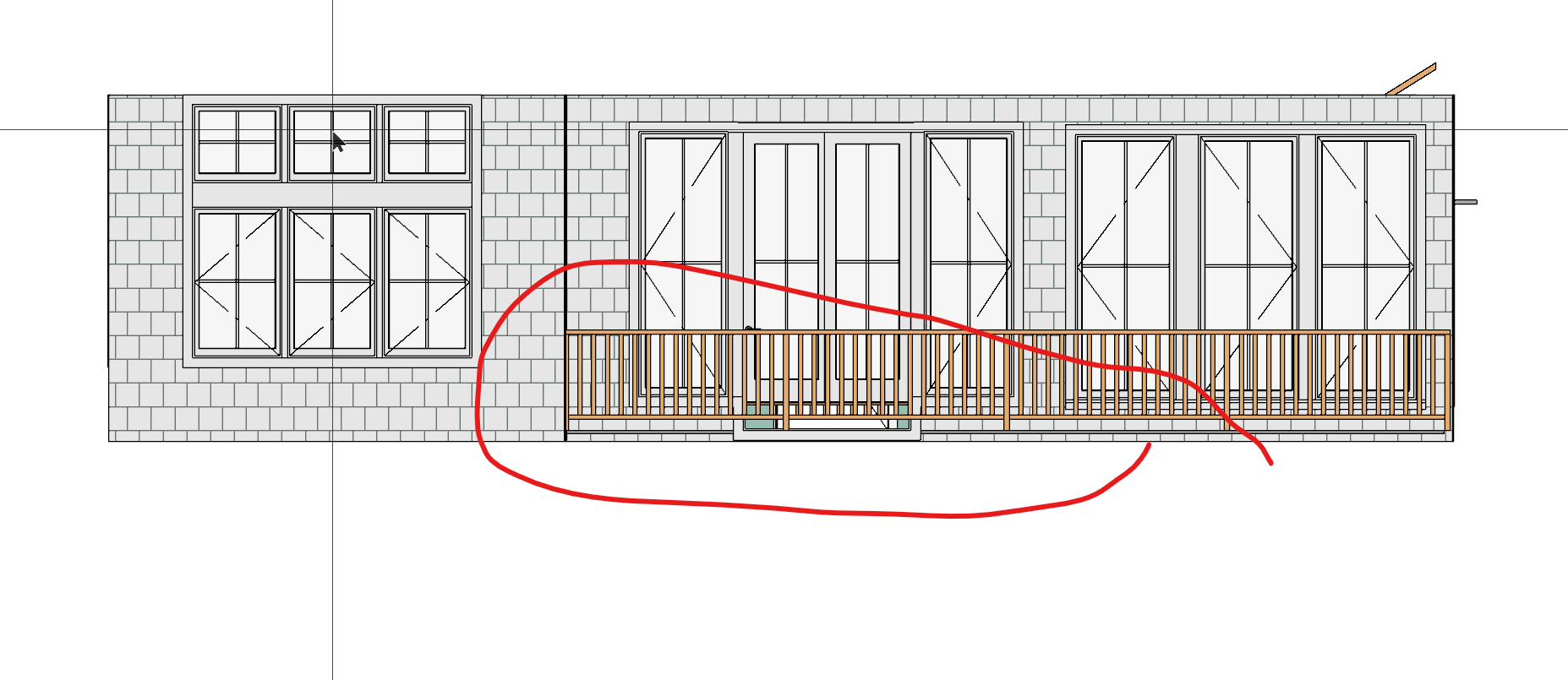

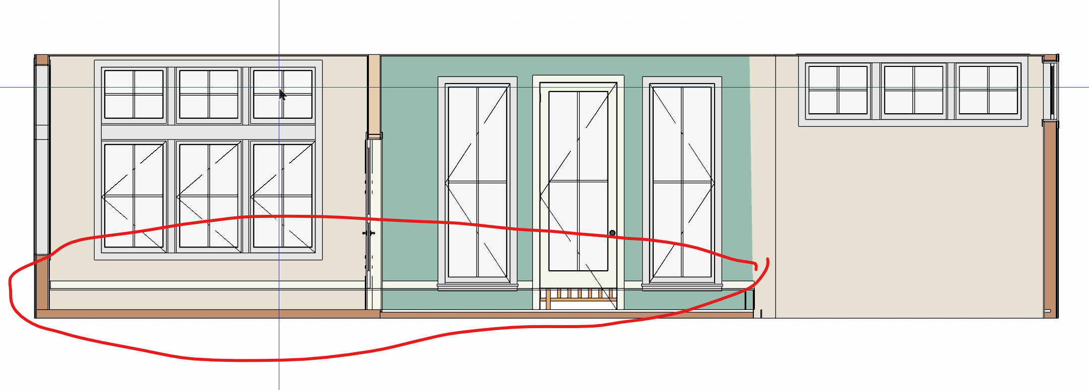

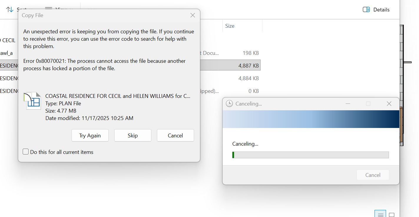

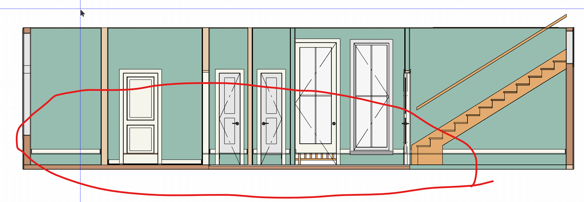

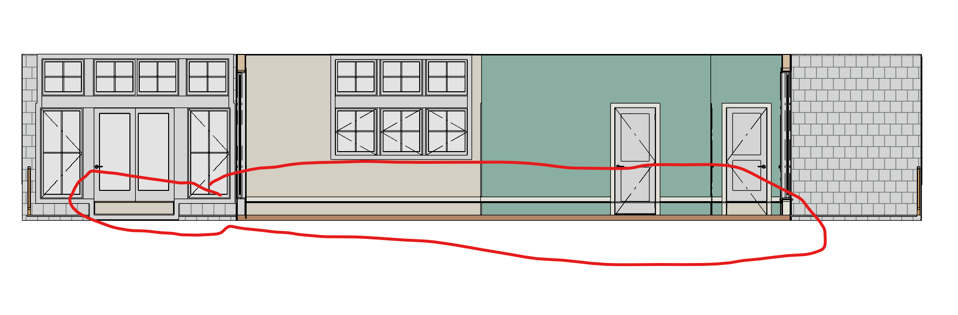

Evolution Posted November 17 Share Posted November 17 In this particular elevation it appears something is wrong with the floor height. I have the floor to bottom of the door / window mulled unit set to zero so why do I have this strange anomaly that appears to make the floor lower in one room than the others? I set all my defaults (I thought) for the rooms to the same floor / ceiling heights, walls, doors, windows, etc. I am unable to attach the file although it is only less than 5000KB and when I attempt to zip it, get a operation failed. Not sure why COASTAL RESIDENCE FOR CECIL and HELEN WILLIAMS for CHIEF TALK FORUM.plan Link to comment Share on other sites More sharing options...
Evolution Posted November 17 Author Share Posted November 17 EDIT: See if you can open the files I was able to zip another way. COASTAL RESIDENCE FOR CECIL and HELEN WILLIAMS for CHIEF TALK FORUM.zip Link to comment Share on other sites More sharing options...
GaryOhmer Posted November 17 Share Posted November 17 You put a floor over a floor - instead of a floor covering you built another floor Link to comment Share on other sites More sharing options...
Evolution Posted November 17 Author Share Posted November 17 Gary, I just noticed that in my defaults. Not sure why, but it's fixed! Link to comment Share on other sites More sharing options...
