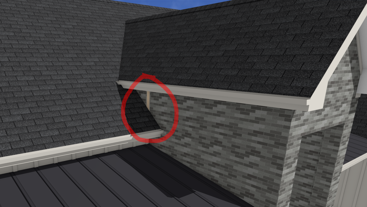

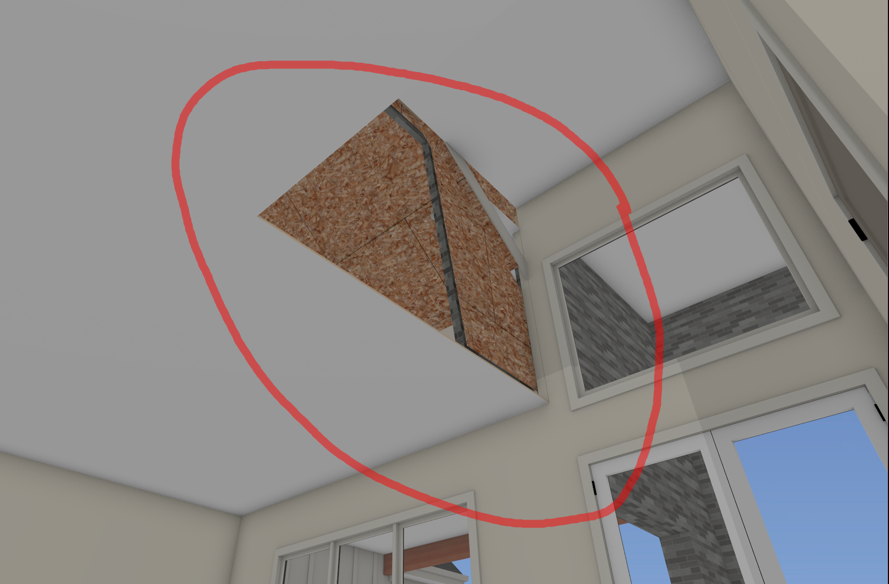

Jakereinhardt55 Posted November 9, 2025 Share Posted November 9, 2025 I always struggle making these look right in 3d. The walls on the inside of the house aren't showing up correctly and also having some wall intersection issues. Im attaching photos since I done exactly know how to describe it and also the file. Linette Brooks.zip Link to comment Share on other sites More sharing options...
Mark3D Posted November 11, 2025 Share Posted November 11, 2025 Give this file a go, with interior ceiling fill walls I drew interior walls and dragged up from the floor and exterior attic wall i adjusted it length Linette Brooks Mark edit.zip Link to comment Share on other sites More sharing options...
Jakereinhardt55 Posted November 12, 2025 Author Share Posted November 12, 2025 2 hours ago, Mark3D said: Give this file a go, with interior ceiling fill walls I drew interior walls and dragged up from the floor and exterior attic wall i adjusted it length Linette Brooks Mark edit.zip 6.9 MB · 1 download Ya that kind of works on the inside do you think just adding a second floor for the area with the high ceiling would fix that problem? Link to comment Share on other sites More sharing options...
Mark3D Posted November 12, 2025 Share Posted November 12, 2025 51 minutes ago, Jakereinhardt55 said: Ya that kind of works on the inside do you think just adding a second floor for the area with the high ceiling would fix that problem? Not sure give it a go the added floor might be better, if you don't want to see those walls on first floor put them on different layer so you can turn off Link to comment Share on other sites More sharing options...
