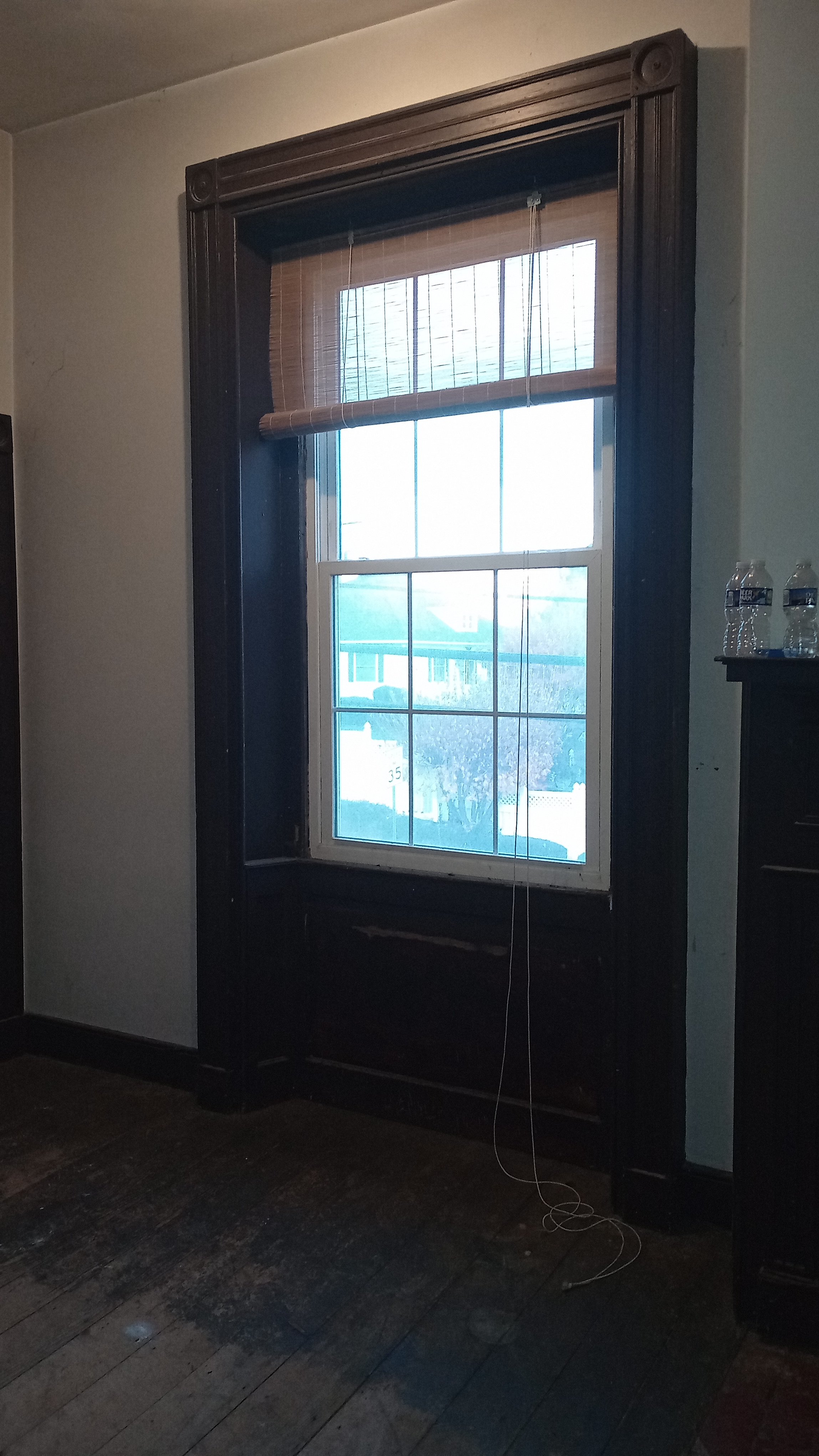

Dutchworks Posted November 9, 2025 Share Posted November 9, 2025 (edited) Can someone point me in the right direction for creating a window like this? I'm using CA X14. I will get a better picture later today. Edited November 9, 2025 by Dutchworks Link to comment Share on other sites More sharing options...
DBCooper Posted November 9, 2025 Share Posted November 9, 2025 You can get pretty close using a "fixed door" by setting the bottom of the frame larger and making 2 vertical lites. If you need it to look more accurate, you would need to use a door symbol. Link to comment Share on other sites More sharing options...
JKEdmo Posted November 9, 2025 Share Posted November 9, 2025 7 hours ago, Dutchworks said: Can someone point me in the right direction for creating a window like this? I'm using CA X14. I will get a better picture later today. You might be able to do this as a vertically stacked mulled window. Top window double hung / bottom window with solid panel (change glazing material to opaque). At least that's the approach I'd take. Jim Link to comment Share on other sites More sharing options...

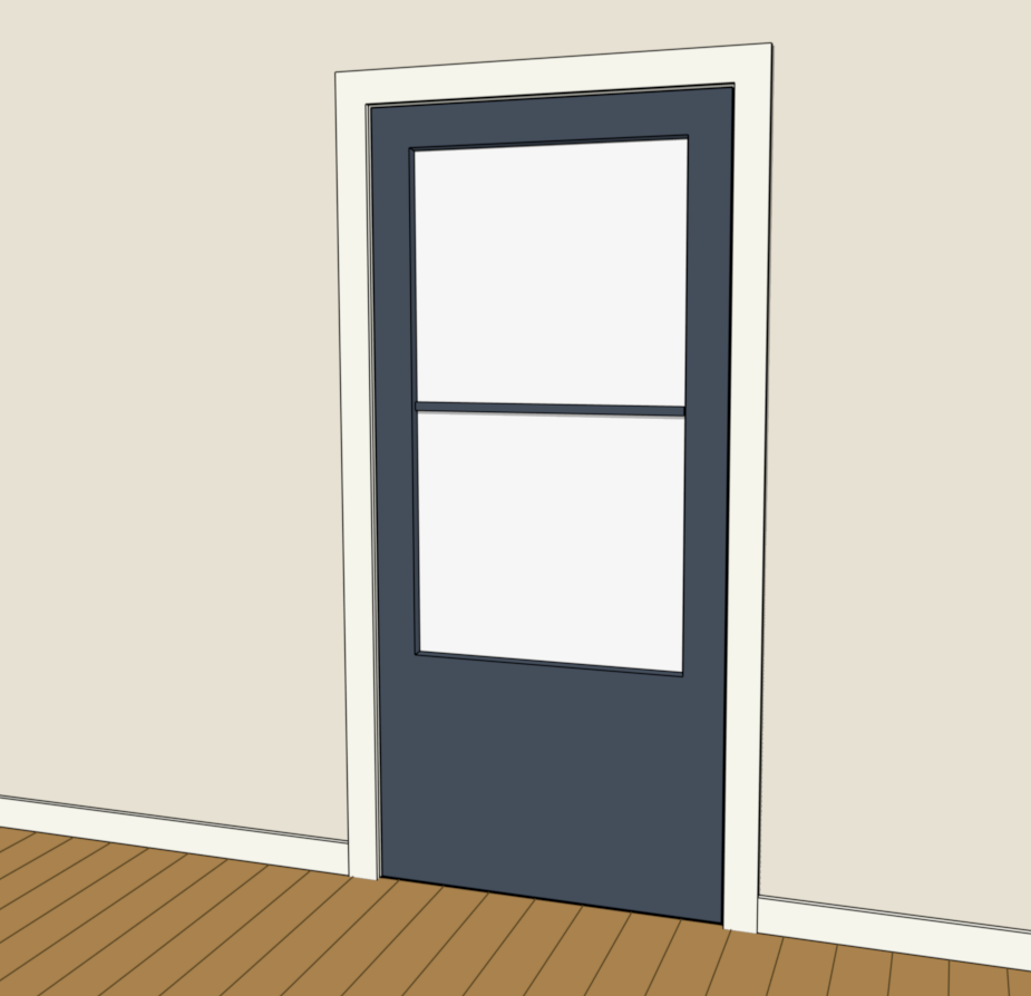

Dutchworks Posted November 10, 2025 Author Share Posted November 10, 2025 Thanks for the replies guys, I will try the door option first and post a screenshot. Give me a few days though... Link to comment Share on other sites More sharing options...

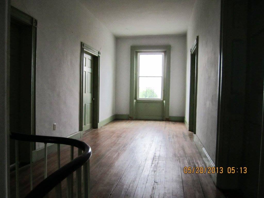

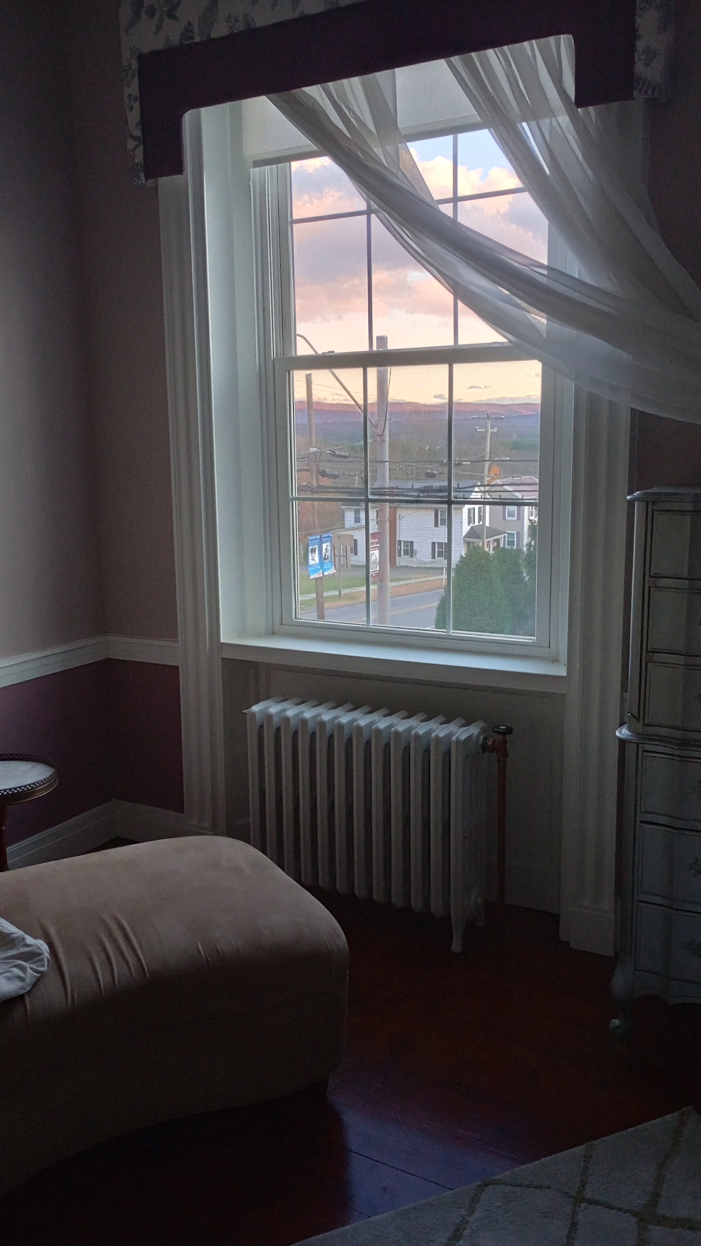

Dutchworks Posted November 10, 2025 Author Share Posted November 10, 2025 Took some pictures today, I'm recreating one of my bedrooms so I can depict my renovation and create custom cabinets I want to build. Link to comment Share on other sites More sharing options...
