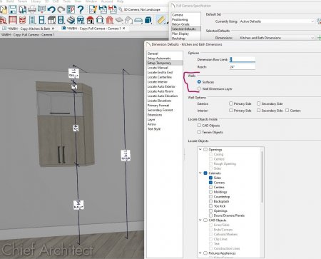

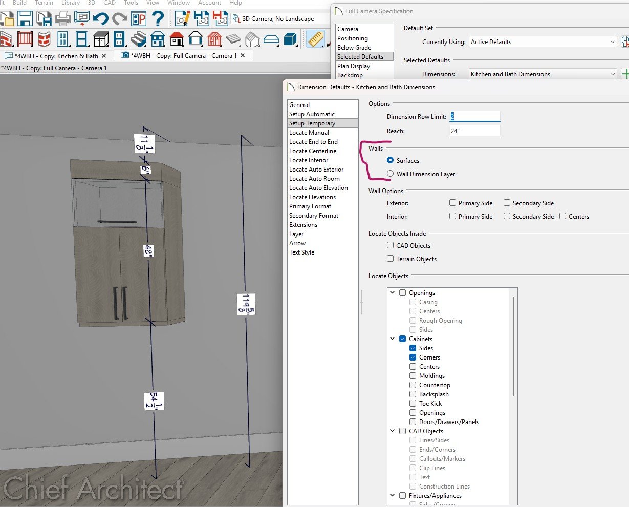

Renerabbitt Posted November 7, 2025 Share Posted November 7, 2025 I feel like this changed? My temp dims are going to ceiling structure not surface Link to comment Share on other sites More sharing options...
scottharris Posted November 8, 2025 Share Posted November 8, 2025 Is your dimension default set to wall surfaces? Link to comment Share on other sites More sharing options...
Renerabbitt Posted November 8, 2025 Author Share Posted November 8, 2025 38 minutes ago, scottharris said: Is your dimension default set to wall surfaces? thanks for responding scott, it was, one of your team and i figured it out, it has to do with it having a tray ceiling, logged as a bug Link to comment Share on other sites More sharing options...
