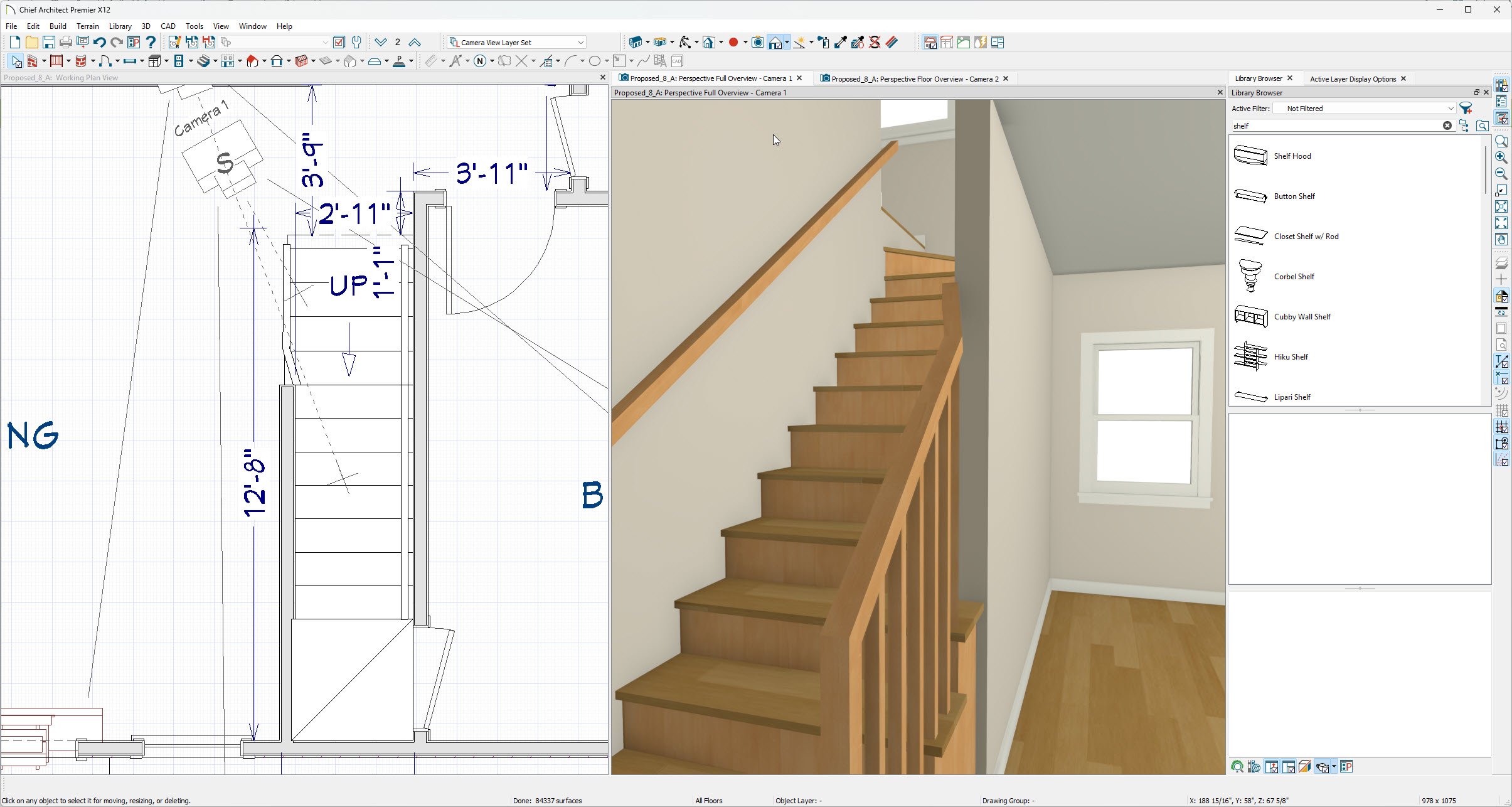

chiefjdennis Posted 13 hours ago Share Posted 13 hours ago Hello I'm having trouble terminating an exposed stair section railing at wall. It wants to wrap inside wall instead of terminating. Is there a specific setting for this? Using CA v12 Plan and image attached Thanks!Proposed_8_A.plan Proposed_8_A.plan Link to comment Share on other sites More sharing options...

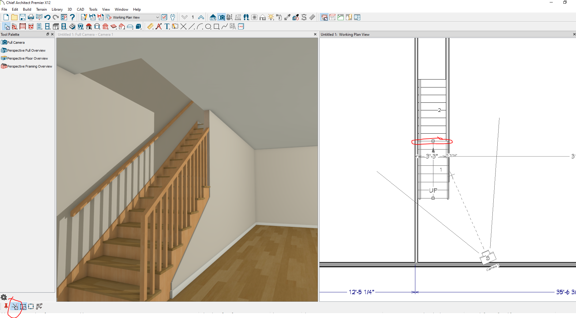

javatom Posted 11 hours ago Share Posted 11 hours ago Move the end of the wall toward the lower stair section. There will be an exact spot where it will work as you want it. 1 Link to comment Share on other sites More sharing options...
chiefjdennis Posted 11 hours ago Author Share Posted 11 hours ago Okay great! Thank you very much Link to comment Share on other sites More sharing options...
Garybills Posted 10 hours ago Share Posted 10 hours ago You can also make a complete break in the stairs wherever you need the wall to end. 1 Link to comment Share on other sites More sharing options...
